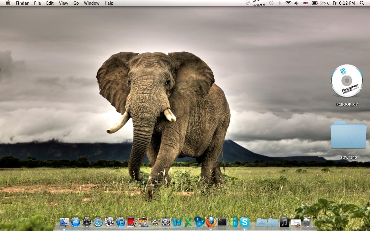

Just an update:
- Yes, calibrating the battery as stated on apple's support page solved the issue.
To those who asked what I was doing:
Not much! I had firefox on facebook, skype online, msn online, and irc online. No calling, no video, no music. Brightness was 3 blocks, no intensive processing going on at all.
Now, after doing the calibration process..
Just as I unplugged the power cord, I got around 10 hours (of doing nothing), I think that's about right. 🙄

Just an update:
Good to hear! Hope everything continues to work out well with your battery.
