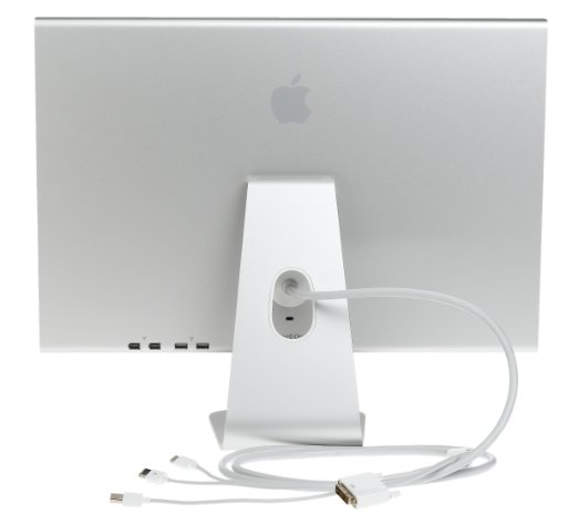

The display connects with a white hdmi and a whole power seperate power unit .with a connection that looks a lot like a small USB , not thunderbolt though.
http://images.highspeedbackbone.net/itemdetails/T87-723001/T87-723001-out02-am.jpg
These are the connections but like I say there is also a seperate power supply for one of the connectors to plug into.
Regarding how I've plugged it in, all that is connected is the hdmi and this one other connection, leaving two of them unplugged...is this correct?

I have to admit I'm no Cinema Display expert. But, the cable image looks to have a mini-displayport (the smallest one that isn't USB). Mini-displayport and Thunderbolt look the same. Does the video card in the Mac Pro have the mini-displayport jack?

Looking at your attached image on the Apple display cables, it looks like you have a 30" aluminum Apple Display, the older model released in 2005. As reading thru your description, it has a separate power supply, which could be the white block design though I could be mistaken.
For the flickering problem mentioned from your first post, it could be a problem with either the power supply, or the video card or cables loosely connected.

I've just checked the display and it all it says is 'Apple Cinema HD Display '. It has4 ports on the back aswell , two USB and two others that are the same connection used to link it to its power device/box
