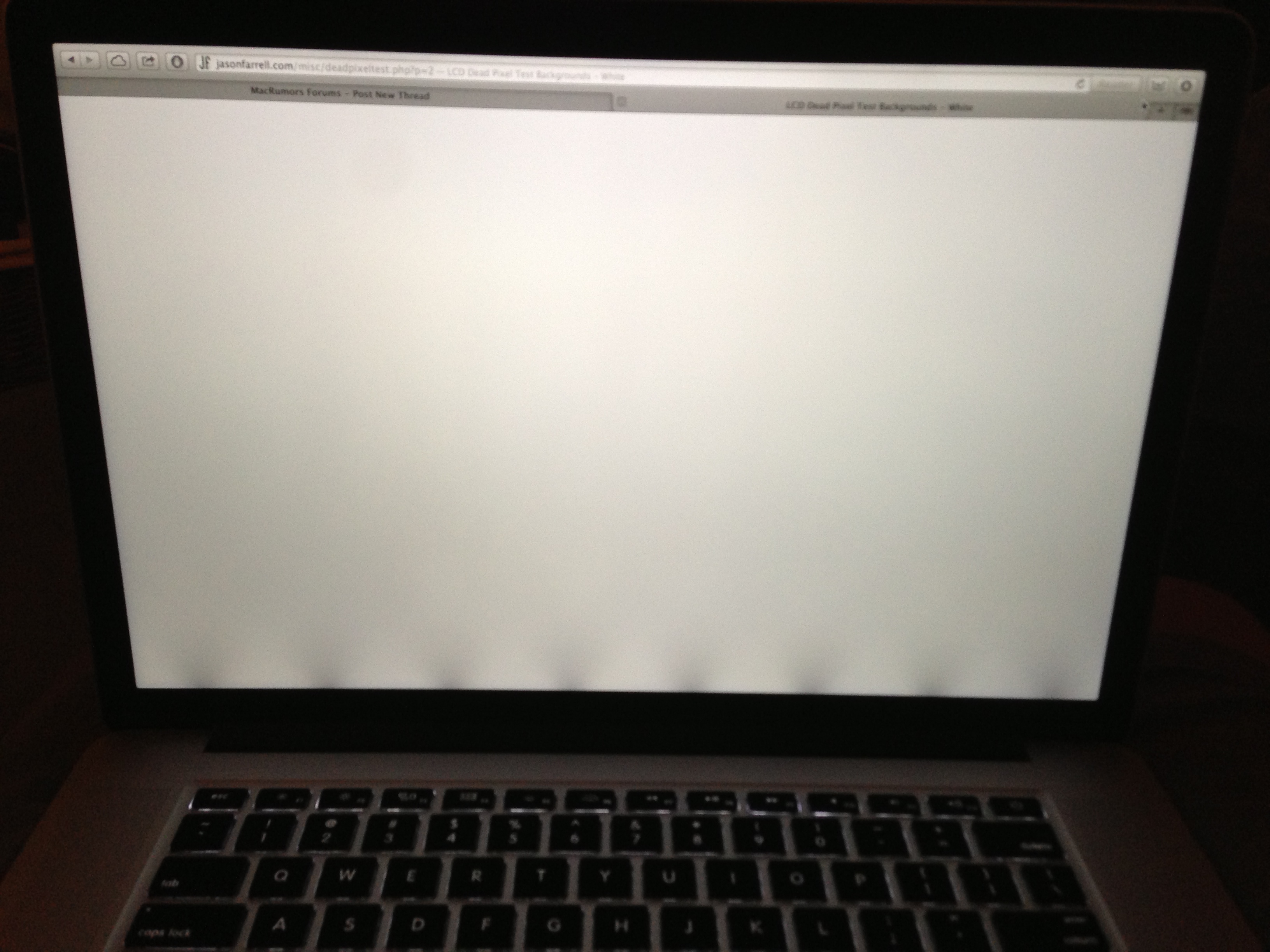

So today I brought my 15" rMBP to the genius bar today because of a loose hinge, thought I'd get it tightened before my applecare ran out next week. But I got home and turned it on and now there are dark spots on the bottom of the screen. I don't know how these screens are assembled but is there a chance the tech tightened something too tight? I plan on bringing it back tomorrow to solve the problem.

its not dark spots, its white spots...
those are what they called as backlight bleeding...
yeah, just get it to genius.
In this case it looks like half of the backlight is failing to turn on, basically every other LED is off, creating the dark spots. Definitely take it back to the store.
Take it back to the store and let a Genius take a look at it. They should be able to diagnose and fix the issue. Let us know what happens and the end result.
So I just left the apple store, genius said they probably tightened it too much and damaged something, so they ok it in for a new display.
Also I asked if there's any way to make sure it doesn't get an LG display and he said they're all the same.. so I'm hoping it's a Samsung.
Update: Got my computer back today, checked the display manufacturer through terminal, it's a Samsung. Success!
