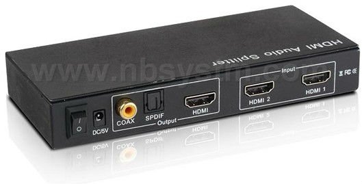

By the sounds of it your only option will be a hdmi audio extractor. I just got one myself a couple of days ago to use with my atv4 and works perfectly.

in the meantime i think i will get an HDMI audio extractor
