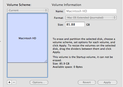

I decided to delete my Boot camp partition as i was running low on space, yet when i go to disk utility, under partition, my mac hardrive has only 85 gb dedicated to it. Below it, there is a grey area, im assuming this is another partition, that is consuming my harddrives remaining space. I cant seem to delete that partition, or resize the mac osx partition. as i get an error with both attempts....

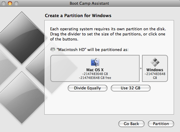

well first thing bootcamp says is u need at least 10 gb...will it allow me to delete it after i clear up some space. Cause i don't believe bootcamp still exists on my comp, partition wise answays.
wtf look at this!i free up space, and this window came up
Your disk directory is definitely corrupted. If you still can (and don't already have a backup) backup any important files before proceeding any further because trying to fix that error can in some cases render the disk unusable without a full erase. 🙁
After you have backed up anything important if possible, boot up from your System Restore Disk 1 (or retail OSX install disk) and run Disk Utilities from the menus on the disk (when the installer is at the first screen). Try a "Repair Disk" from the "First Aid" tab though I have a strong sense that it wil not clear it up.
That particular type of directory damage usually responds well to a session with Disk Warrior if you own a copy.
