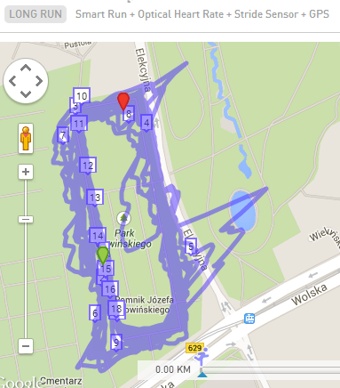

But since (I think) iOS 6 or so, Apple introduced some extremely laggy smoothing to GPS data, so what you see now is where you were some XX seconds ago. It doesn't give you raw data, but "we know better, eat what we feed you" data. This makes GPS on iPhones not a true sensor, but some toyish POS. You can see it by yourself by moving and stopping suddenly, or accelerating fast.
So, unfortunately, you can't consider iPhone GPS as a true sensor that would land its measurements within sigma circles - the data is so heavily F'ed up by :apple: that you never really know what you're looking at.

You nailed it. Apple doesn't care about the correctness of the data, it only cares about their location service look good and smooth. So the blue animated circle may not reflect accuracy accurately - it's just a pretty gimmick. (If you zoom out the map, the circle would appear having a radius of hundreds of miles which has nothing to do with accuracy.)
If you are, however, serious about GPS data, you need a good external GPS.
So how does this affect apps that measure distance, like fitness apps?
It's been already reported that values from Health app are far from accurate. The hyped new barometer, for example, gives some ridiculous results. Apple doesn't care about accuracy of data. It assumes dumb users. It loves dumb users. Users who see some breathing blue dot on maps or colorful health graphs and scream "Yay! I love Apple! I love my shiny iPhone!" That's all there's there. Don't consider any iPhone sensor as a scientific instrument, it's just a gimmick. Exception: accelerometer and gyro seem to be outputting raw data.
