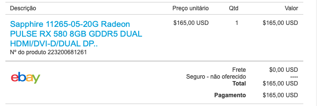

I bought a Sapphire Pulse RX 580 11265-05-20G back in October 2018 for $165 with shipping included.
Good times…
Today I can't even buy a RX 550 with $165.
