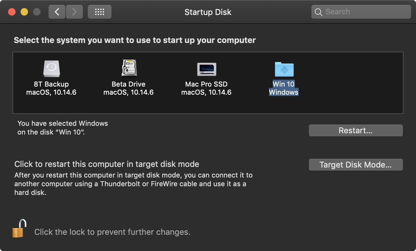

Pentaxer would you mind clarifying what you mean by "there is no need in BootScreen to reboot between OSes." as I don't understand.
Thanks for all your help.
David
In macOS, select Windows from system preference -> Startup Disk

Hi Pentaxer. Thanks for telling me about the performance drop in parallels. That rather sucks. I'm currently in windows 8 via boot camp but cannot find any boot camp apps or the screen that H9826790 posted. I tried searching and came up with nothing. Again I'm not very tech savvy so if you have time would you mind going step by step on how to find them?
Thanks,
David
