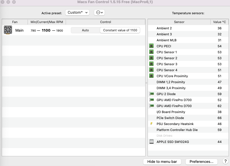

I upgraded my CPU, but the GPU temperature is higher than before, and the temperatures are quite different between the two, 10 degrees difference.

I did repaste the GPU yesterday, but I found that it has nothing to do with temperature difference.
Interesting is that after reboot, the difference is still about 10 degrees, then later ( maybe more than 1 hour) the difference is gone.
I forgot to take the temperatures before the upgrade, so maybe it is just normal, D700 produces more heat than D500 and D300, even just browsing the internet.

I run the Unigine Heaven benchmark yesterday, the GPU 2 diode reached 83°C. Then I did a clean install of macos, during the installation, the computer is hot. After the installation, the temperature becomes normal. During the normal use (fan speed is 1100rpm), the temp for GPU 2 diode is around 45°C.
Then I run the Unigine Heaven benchmark again, this time the highest temp for GPU 2 diode is 73°C, for GPU 1 diode is 54°C. (fan speed is 1100rpm)
