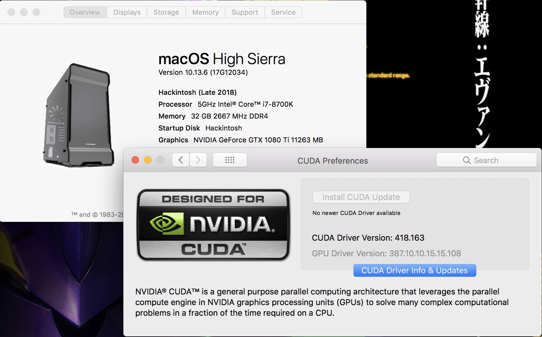

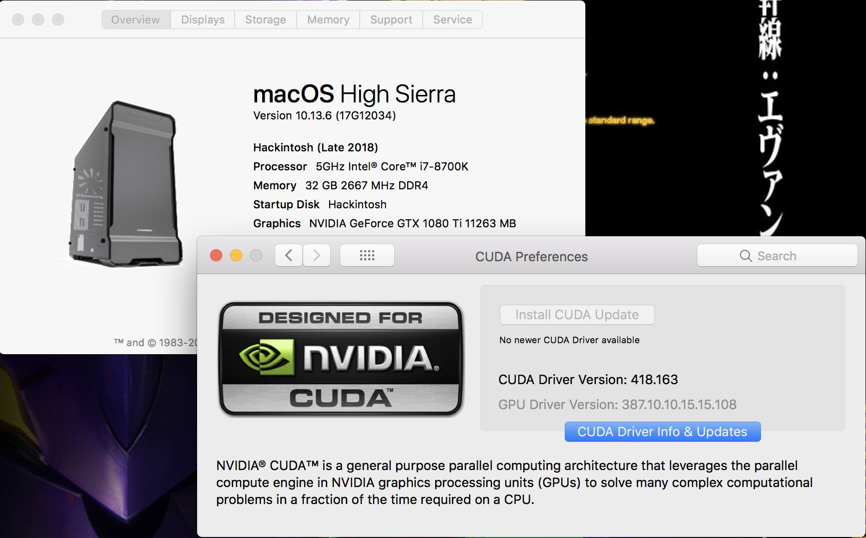

Why not just install web driver in high sierra?
There is no more update for High Sierra, no need to worry about update macOS may break the web driver. Even there is an update, there is a never break web driver for High Sierra already, just install that, then it will work forever.
I installed this never break driver years ago for my 1080Ti, and it never fail.
I installed this never break driver years ago for my 1080Ti, and it never fail.View attachment 1674733
