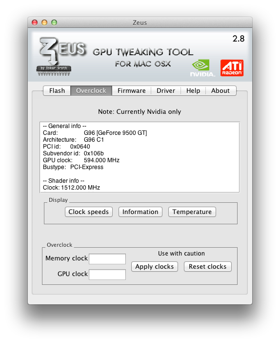

Wow those "unofficial" GT120s are more than the OEMs (in $US). In Windows a Mac GT120 will read as a 9600GT.
I guess because the PC versions are "hard to find" or must have low demand (Econ.101). Strange, Zeus (OS X) shows it as a 9500 GT with 512MB of video memory.
