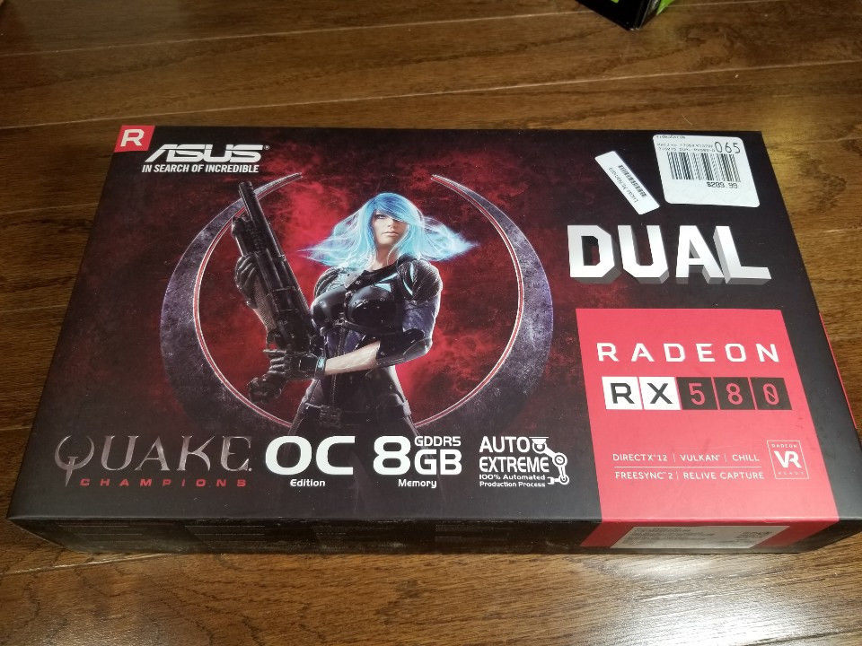

Quick question, i'm looking to buy this card today, i'm concerned with the power requirement , is my mac pro 4,1>5,1 able to poser it?
It depends on the brand of RX580 you get. If you want to play it safe get the Sapphire Pulse RX580 8GB (DO NOT GET THE 4GB VERSION!)
We all know this GPU is in the capability of the cMP. You will need a cable(s) that use both of the mini6 pin connectors on the logic board that go to the single 8 pin port on the GPU. I am not familiar with other brands versions but some may have a higher TPD and would therefore require additional mods or an external power supply to properly power it.
I can 100% tell you the 11265-05-20G model of the Sapphire Pulse RX 580 8GB works fine with dual mini 6-pin to standard 8-pin in Mac Pro 5,1. MANY users will report the same. This is the card Apple recommended for Mojave.
Thanks for responding , i ended up getting this
ASUS Radeon RX 580 OC 8gb
I hope i didn't make a mistake.
