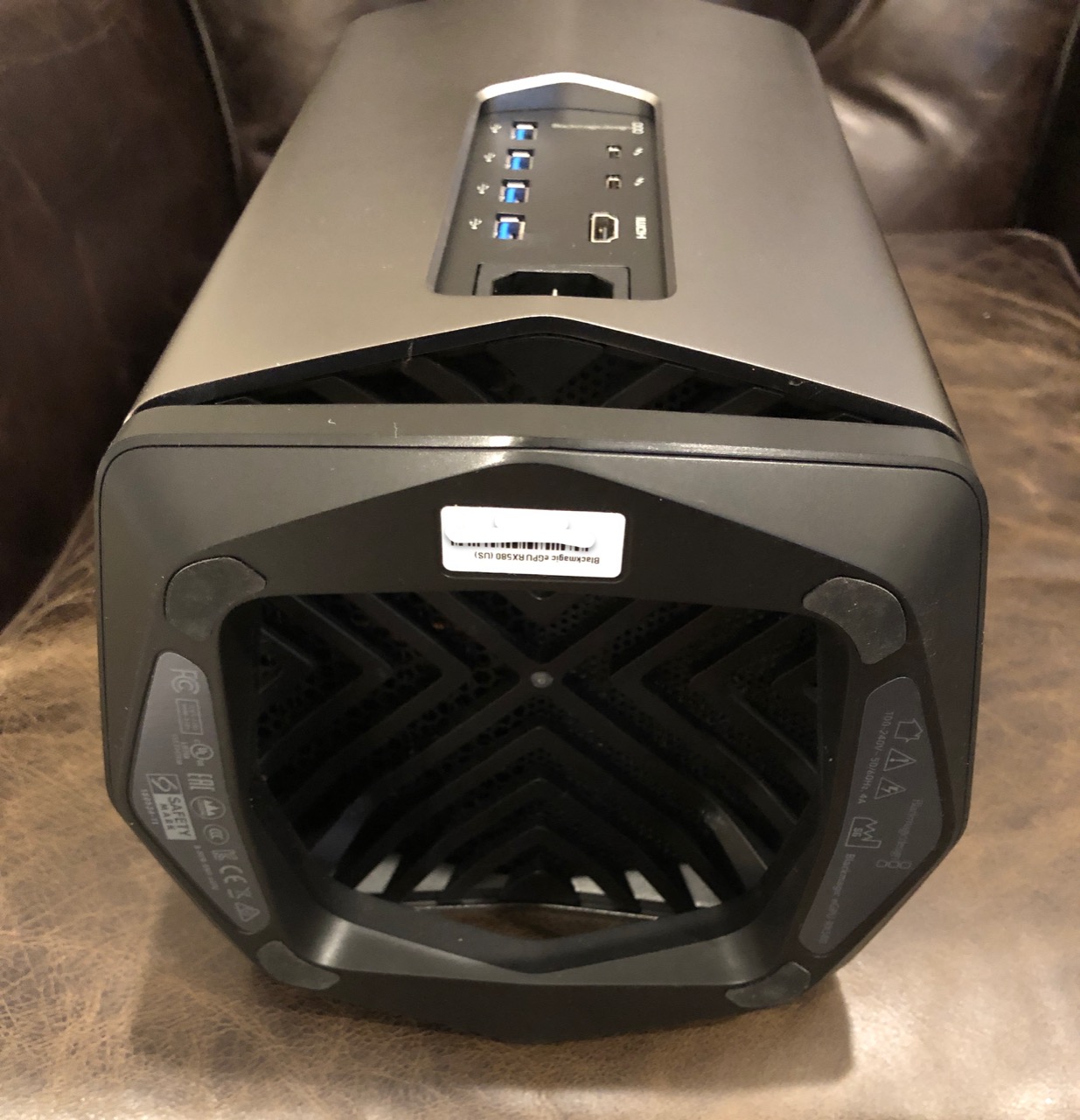

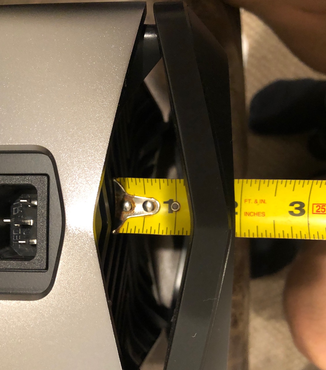

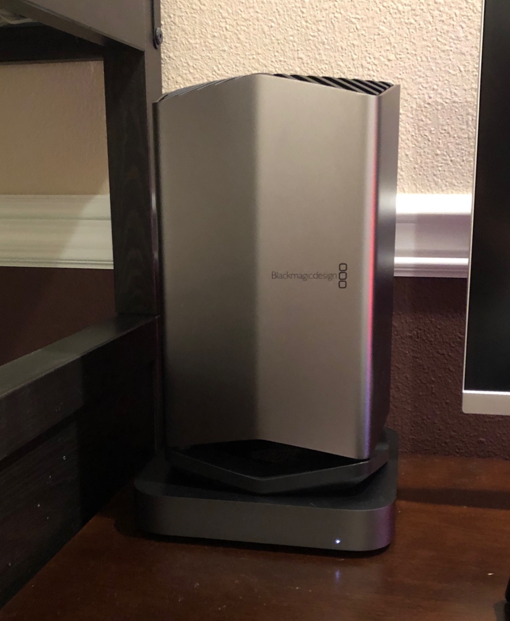

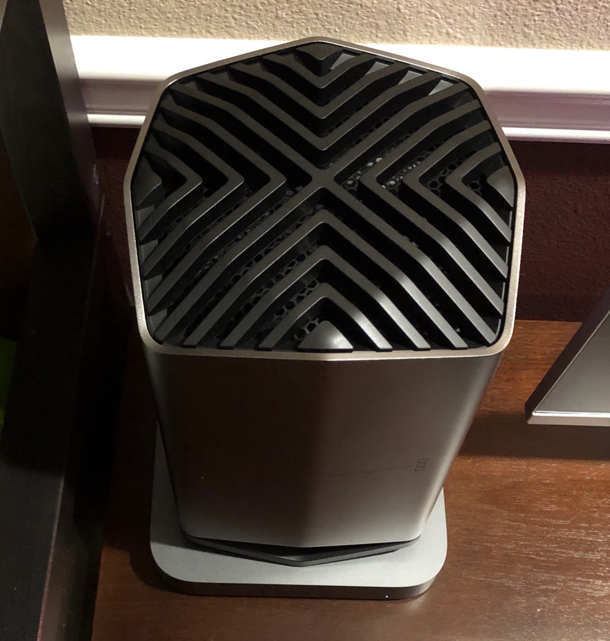

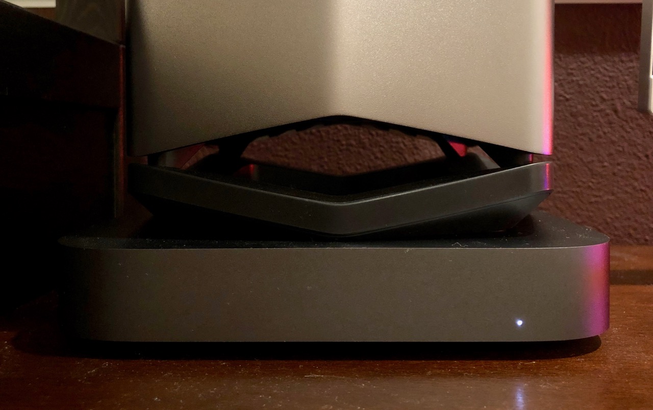

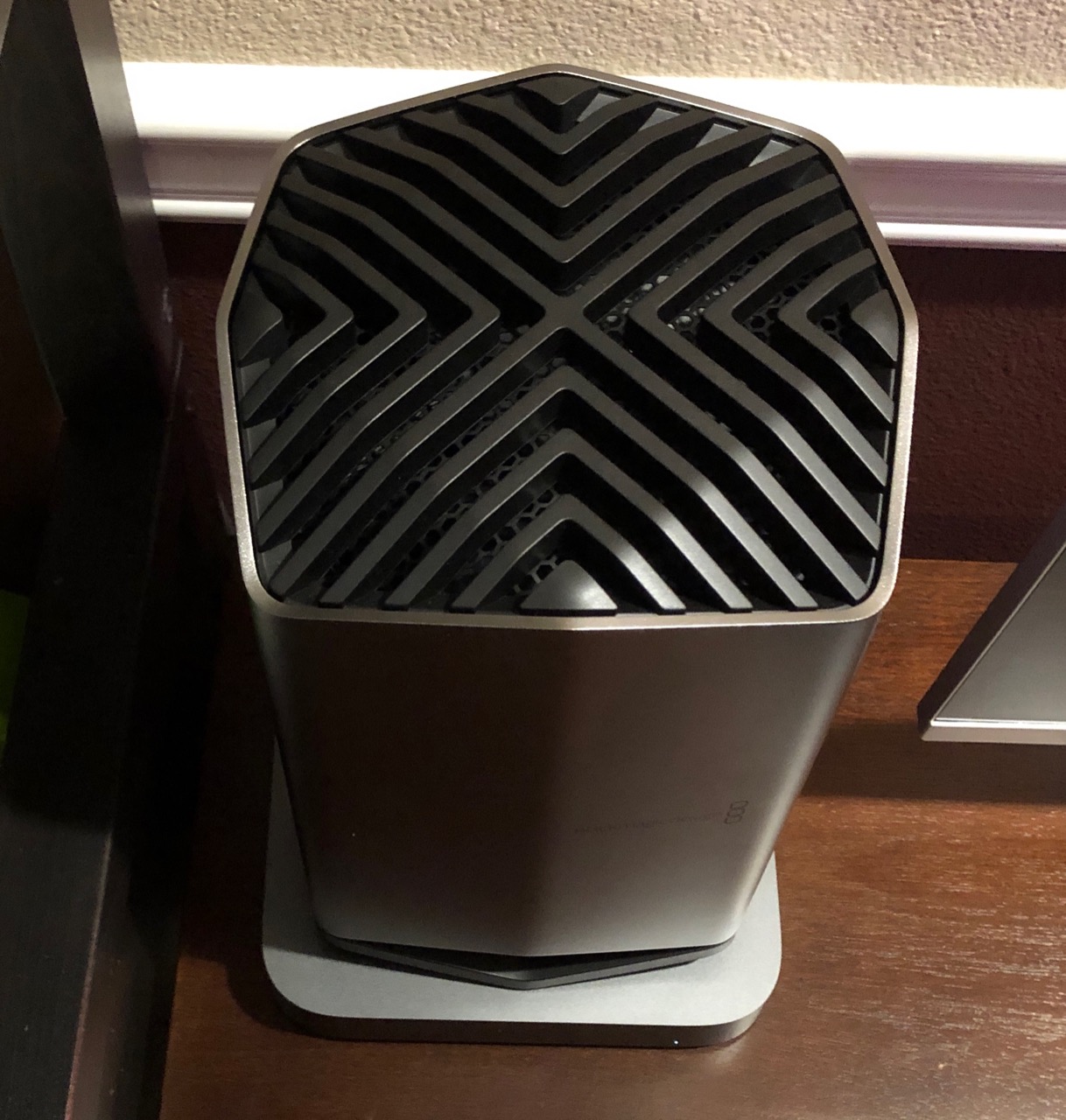

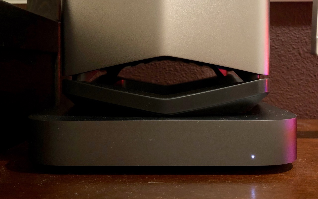

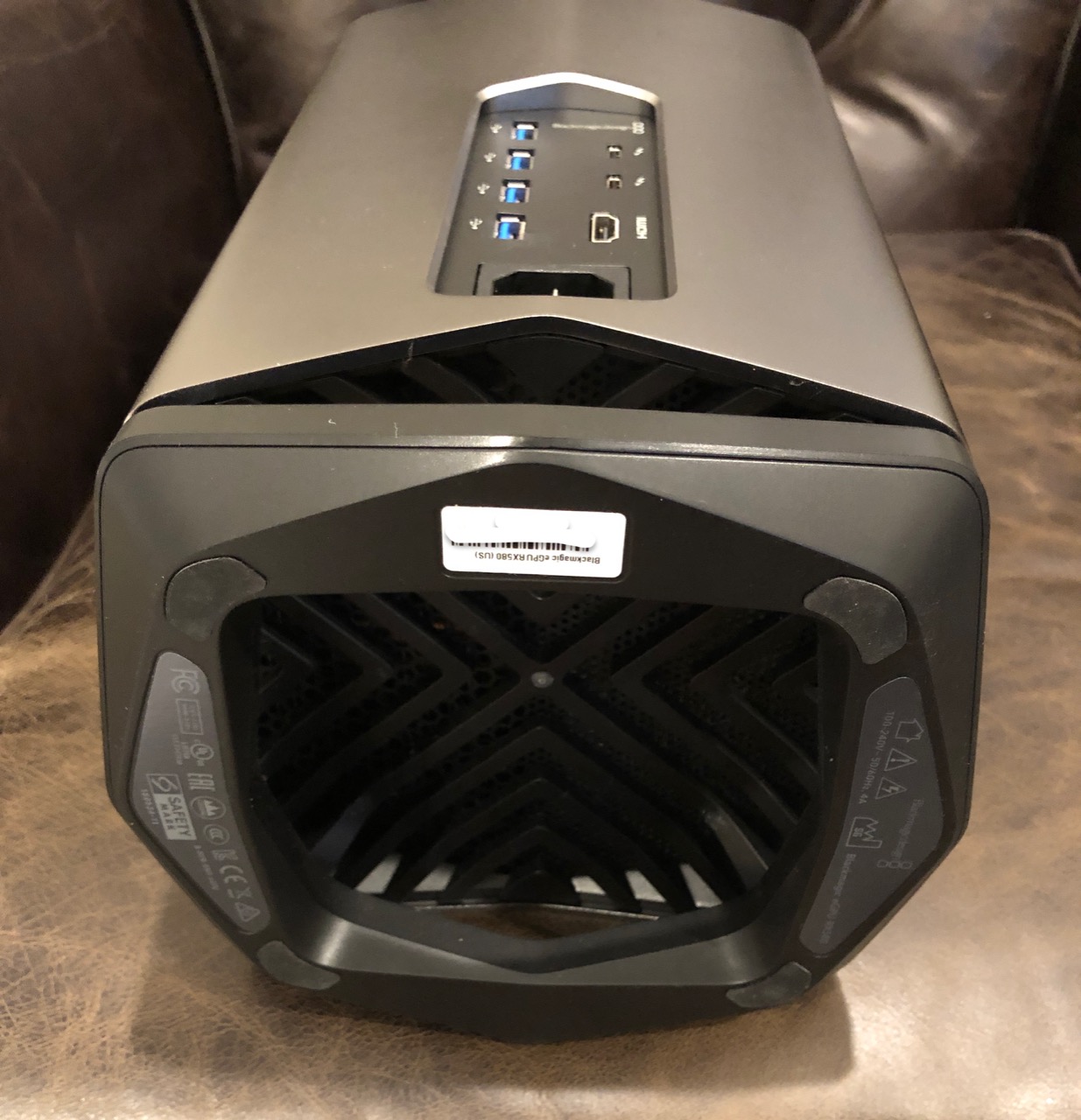

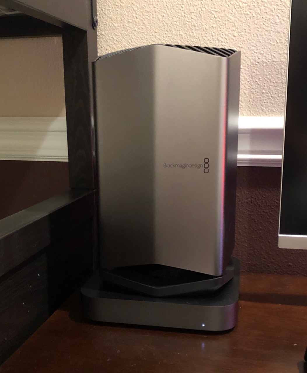

Is this a bad idea? The Mac Mini enclosure seems very strong but this Black Magic eGPU ain't exactly light. It weighs 10 lbs. Granted there are 4 rubber pad contact points so it distributes 2.5 lbs per pad. There still appears to be a lot of clearance. The bottom is an open design with 2 inches of clearance to the eGPU air intake.

I guess it depends how hard you are pushing the Mac Mini, I assume the BM is sucking air from the bottom and expelling through the top? If so and you are pushing it quite hard then you may well be pulling a significant amount of the minis hot air into the BM.
That does not sound like a great idea, you want cool air coming in not warm air, but then it depends on your climate, you may well be doing that anyway.
Reactions: Ploki
Doesn’t that egpu take in cool air from the bottom and let out the hot air from the top vent? I’d imagine that the hot air from the mini would cause problems as the mini can get pretty hot on top.
The weight might also be a problem, having something that heavy on mini.
Right now I have my mini on top of my egpu box (razer core x). It takes in/expels air from the sides so the top stays cool.
You are not going to damage the mini by sitting it on top, if heat is an issue coming from the mini then you will see performance issues. If you can view the temp of the BM then monitor it for a while on top of the mini then away from it.

1071318 has it right in post 2 above.
You DON'T want to do this, because of heat-related issues.
Put the eGPU towards the back of the desk, out-of-the-way...
