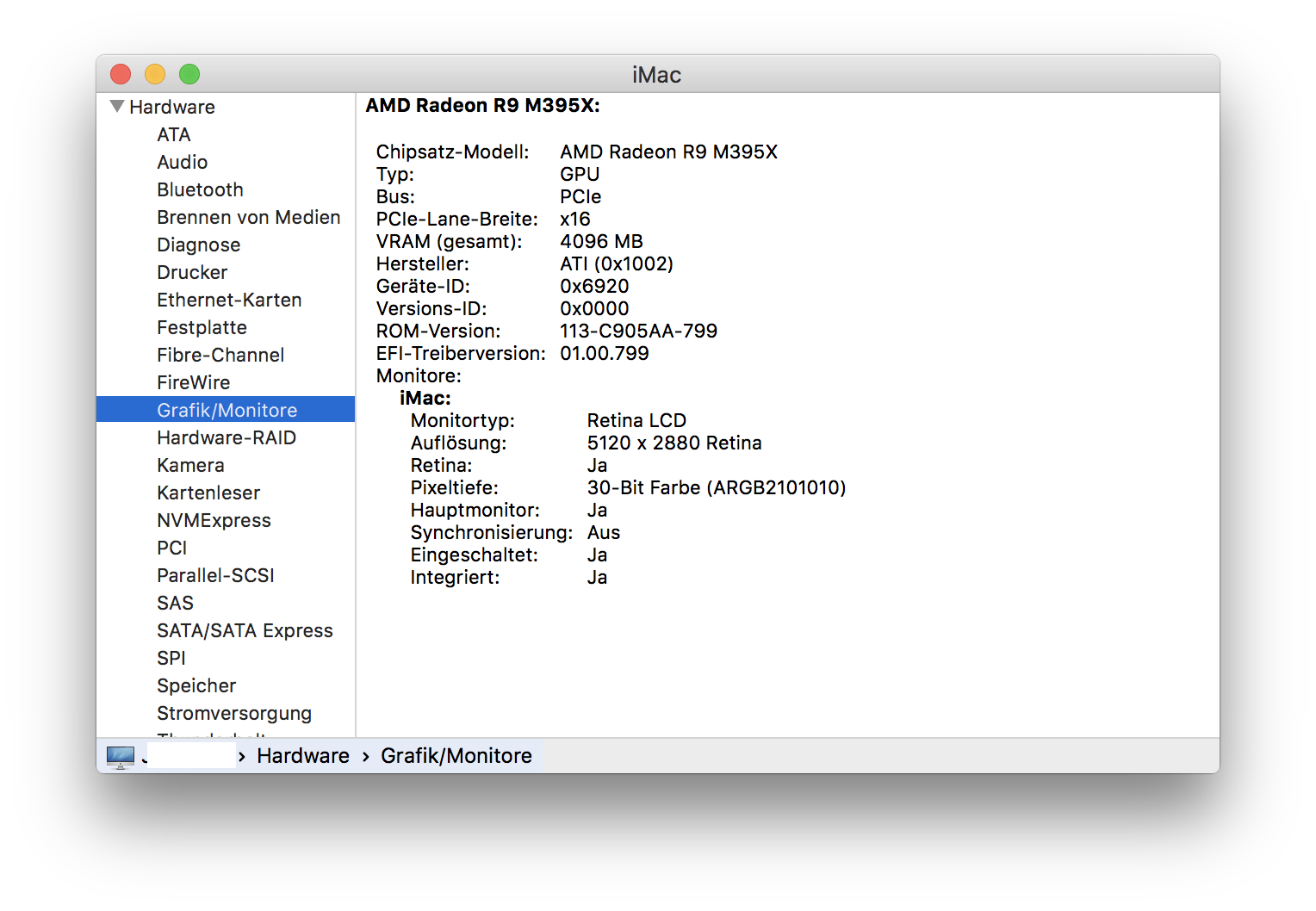

so you're saying there's no way to switch to the iGPU?
I think it's just to slow to drive the 5K screen. It's not even visible in the System Profiler:
Exactly. The option ist not available by default. Don't know if there is a way to hack your way into it, but by design the iMac uses only dGPU.

I think this answer is why.
I forgot that the current Skylake iGPU is pretty slow and there's a lot of pixels that need pushing on the 5k display. That's the reason why the 4k is still on Broadwell - it has a much better iGPU.
