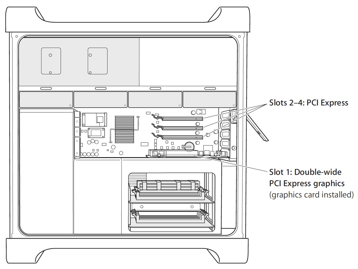

Hi i have a macpro 3.1 with a GTX 660, stuck in the bottom pci slot. The little arm im meant to pull up to get the card out is stuck under the casing of the card 🙁
is there any way to get this out without a lot of pain (will an apple shop pul it out for me?)
I want to give the card a dusting (with air) and move it to the second PCI slot for better ventilation.

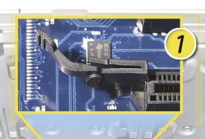

Did you push the button on the PCIe fan assembly (A) and move it to the left? This moves bar (B) to the left, which in turn unlocks the card.
Picture from MacVidCards.
I have no idea what you mean by "arm meant to pull up to get the card out", unless you mean that bar, in which case you are mistaken about what it does. It locks the card in and you don't touch it at all.

Just gently move your fingers over and then under the card towards the leaver and push the little fellow towards you with only one finger (standing, casing on a table and case handles facing north).
Because it's a double wide GTX it's a bit harder to reach and perform this, but just be patient. Good luck!
