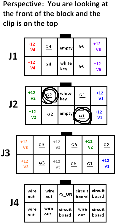

Update about mac pro 1.1 PSU on Mac pro 3.1.
After lot of test about the starting issues i found that on the ps2 soket on 3.1 board the pins 2 and 9 are not ground poles as in the 1.1/2.1 boards. So i decided to cut and after this the psu starts, fan runs, but no chime and no video, the led of cpus A and B lights fix red. I don't know if for the missing correct connections on pin 2 and 9 or if the cpus are bricked, by the way if i get off the cpus the PSU doesn't starts and also i feel that when PSU starts the heat sinks of cpu warms, so i believe is only by the missing wiring on the 2 and 9 pins. Somebody can check what is connected on that poles in a running system?
Last update about 1.1's PSU on 3.1 logic board. To make the PSU starts nedds only to cut 2 wires on the ps2 harness. Looking at the plugger from behind (wires side) with the clip on top, the second pin on top left and the fourth on botton (2 and 9 pins). This cause that on the 1.1 board they are ground and on the 3.1 board they are 12V, 12v1 and 12v2 in order, cause of the greater ampers of the 2.8 ghz cpus. For a good work you should to cut the wires on pins 7 and 2 from ps3 (12pins harness near the pcie power sockets) and connect them on the pins 2 and 9 in order on the ps2 harness. Make this modifies only if you have experienses in electronic, right items, solder etc, and at your own risk. Good luck!

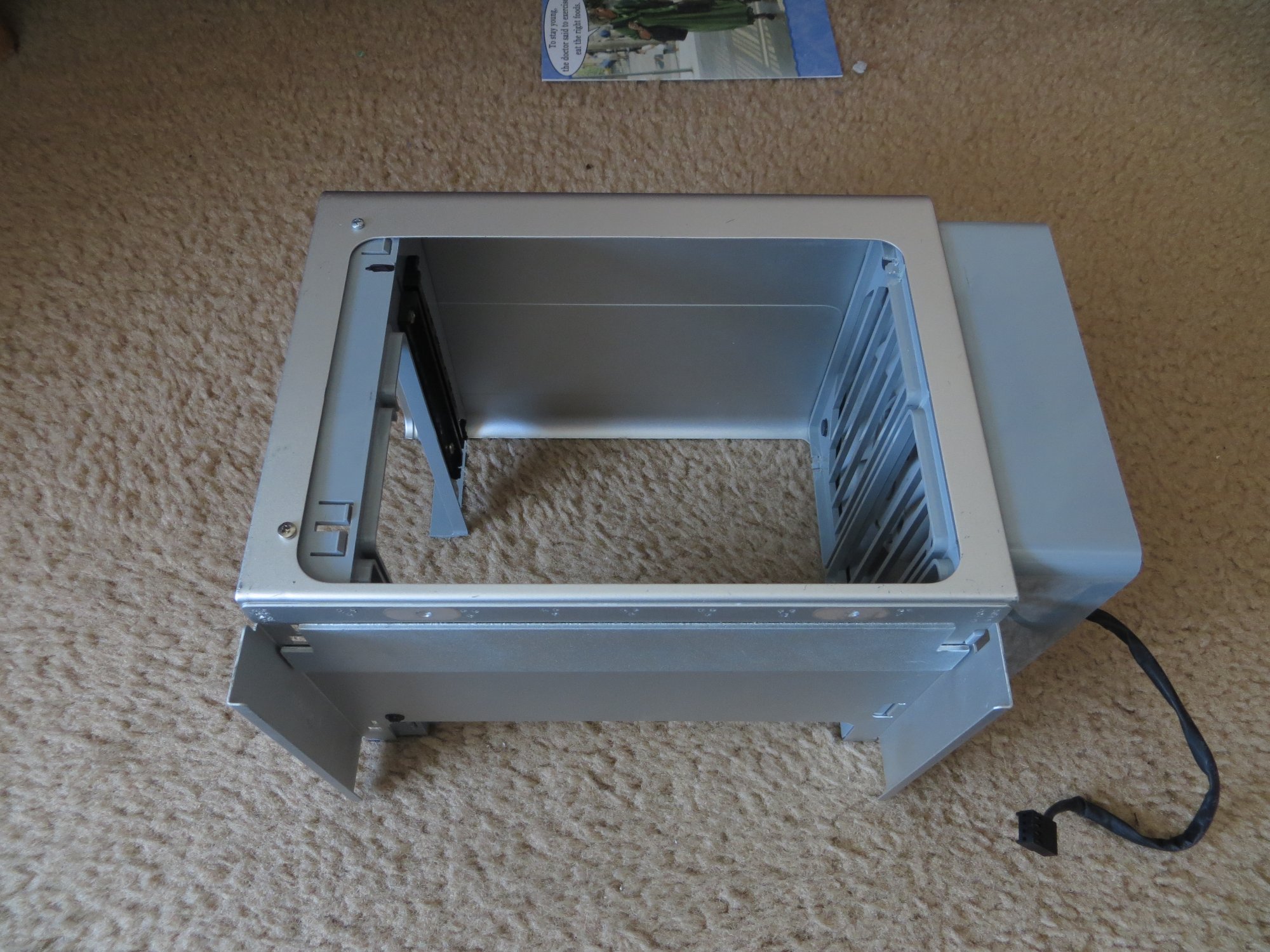

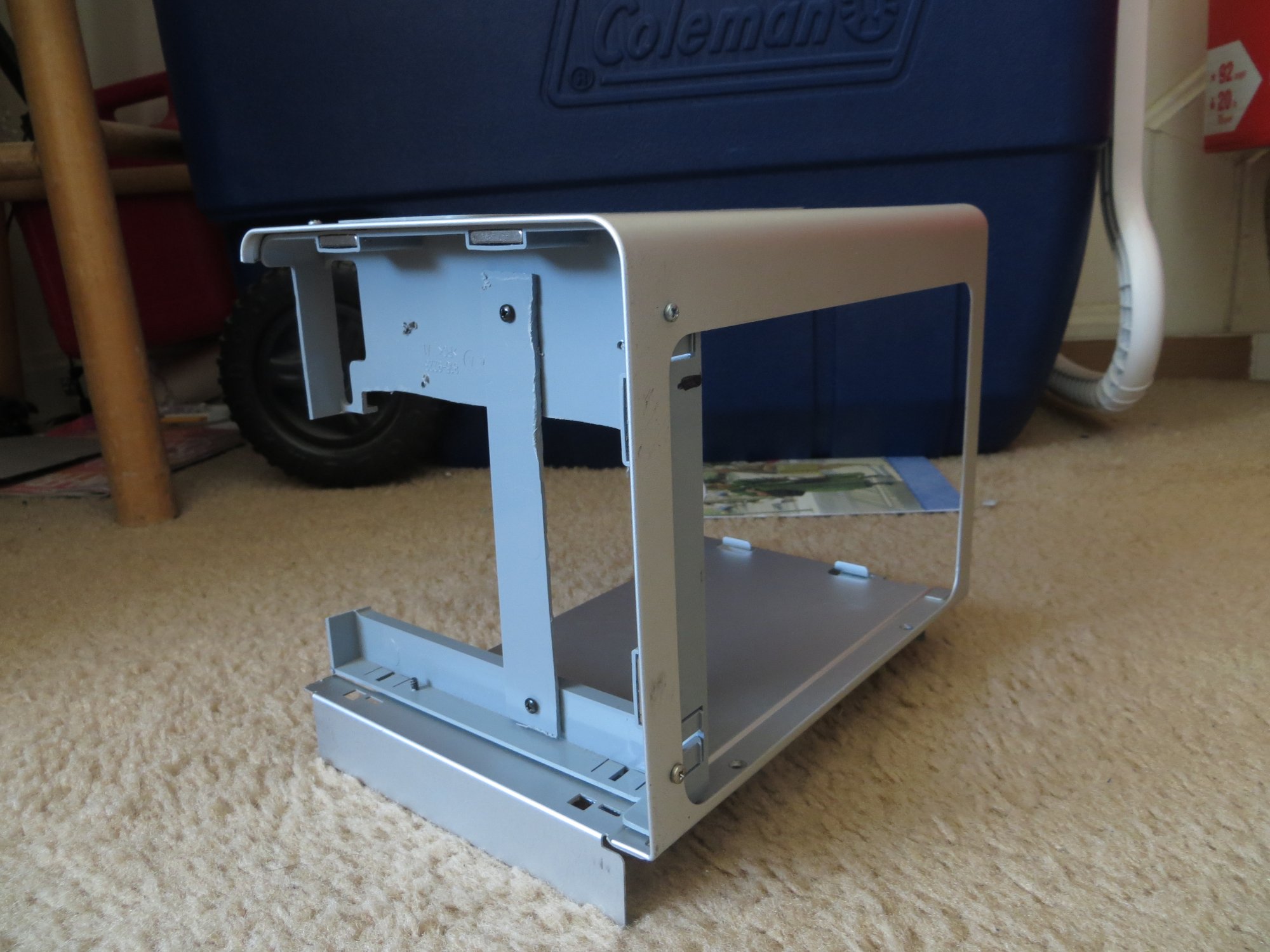

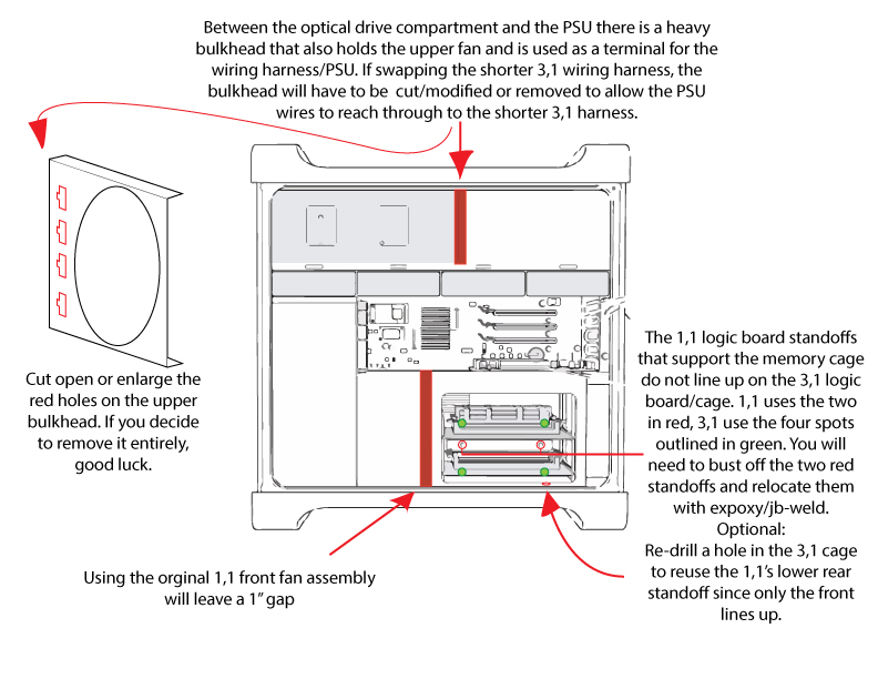

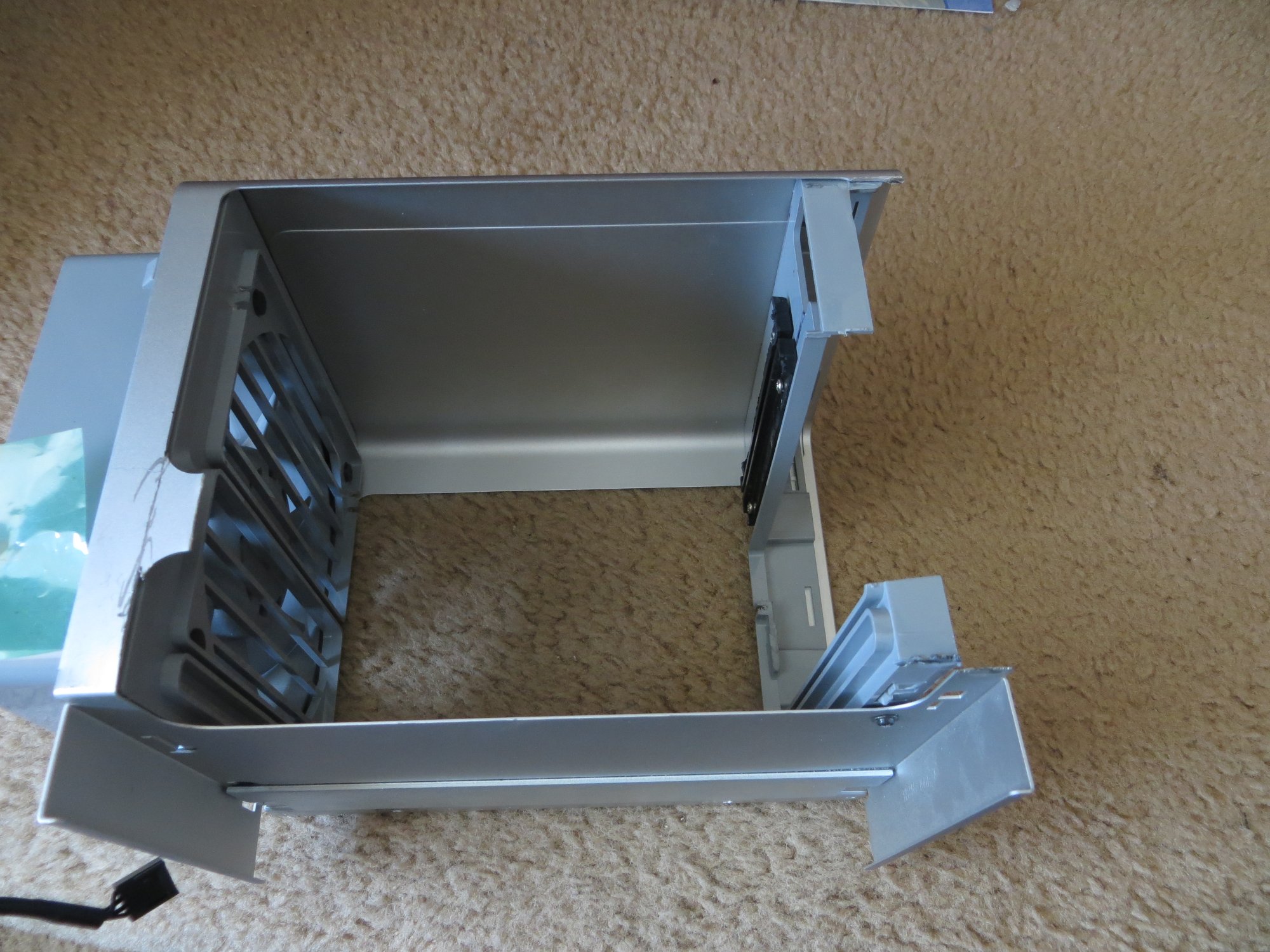

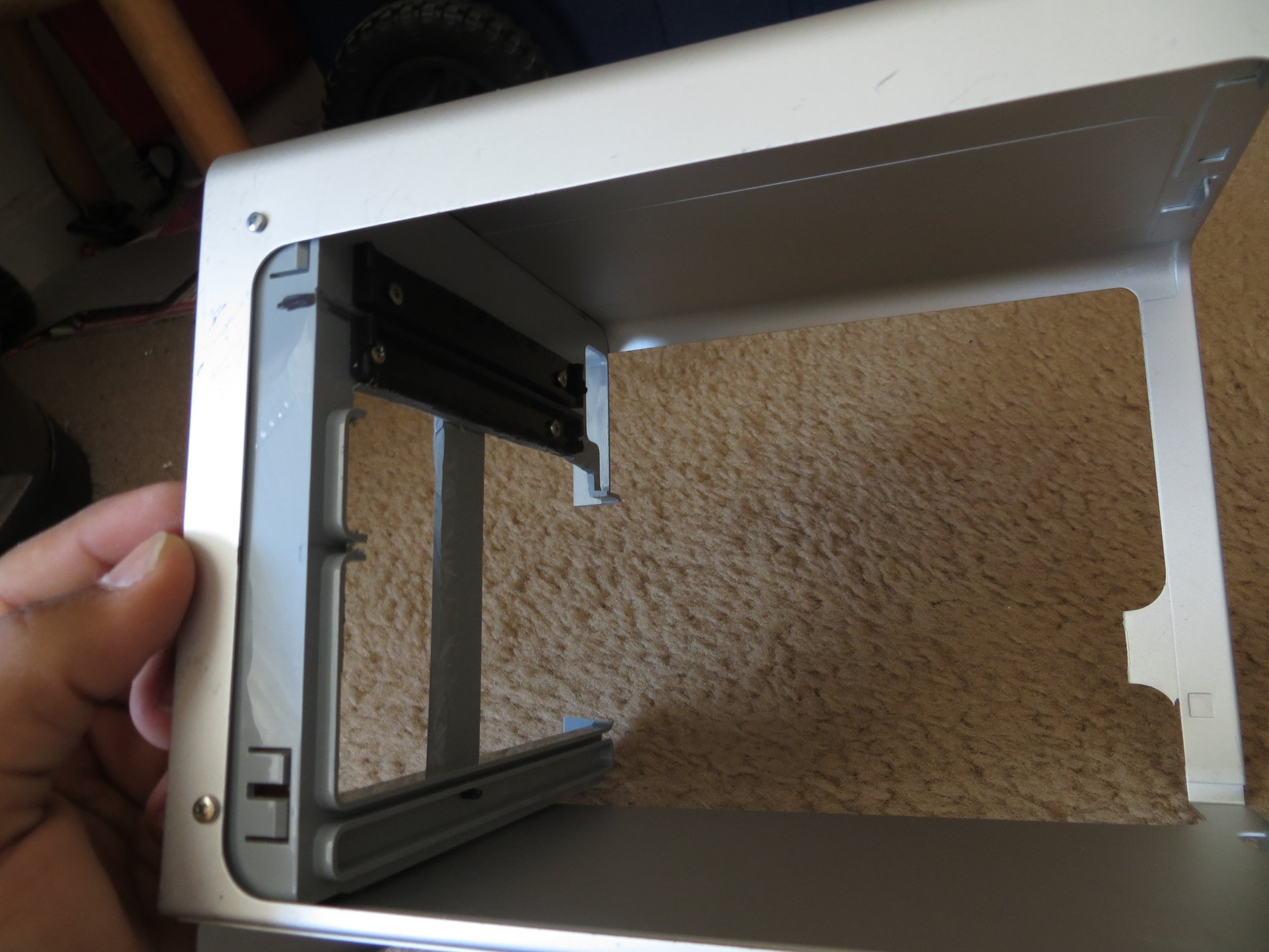

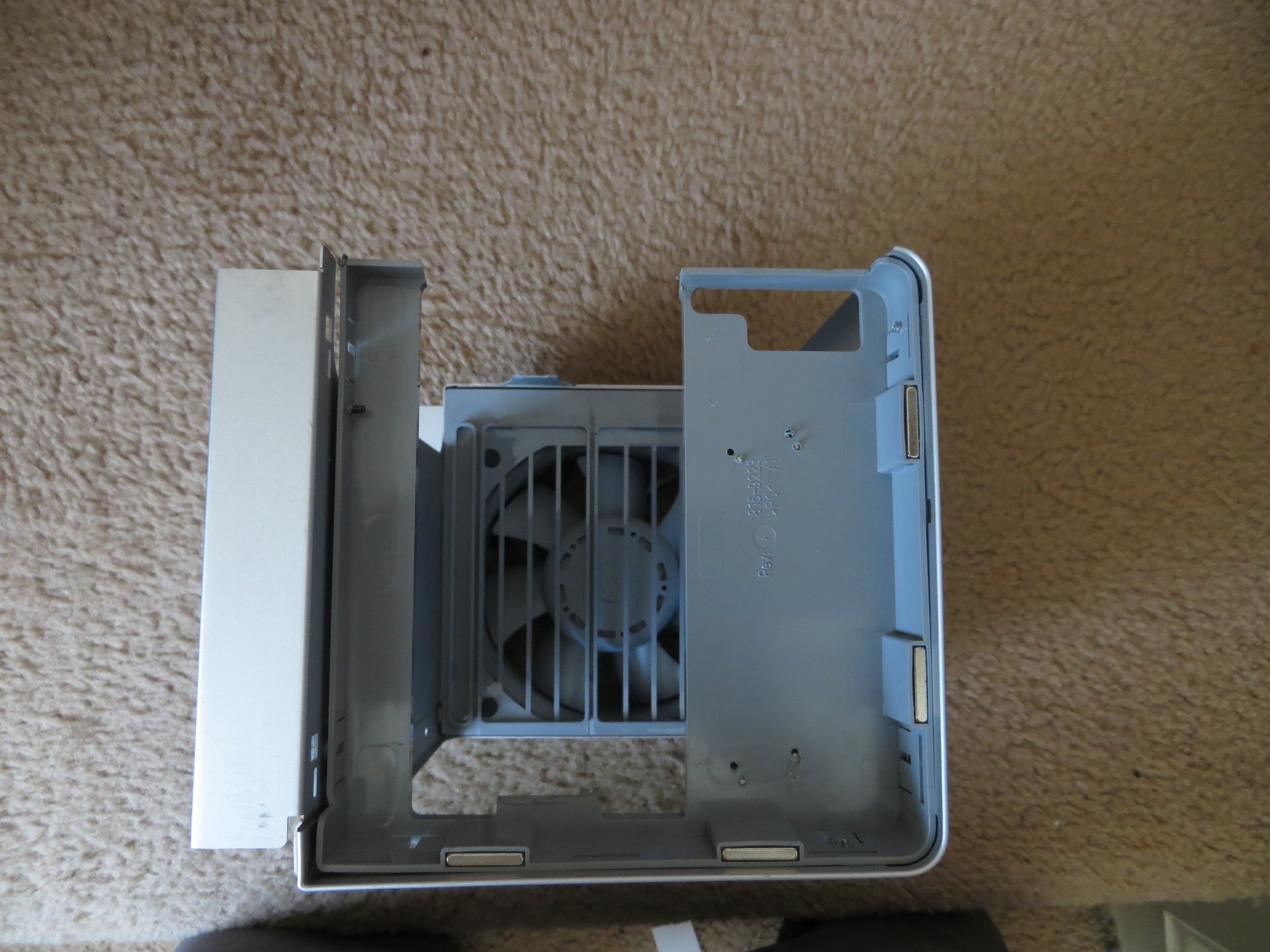

Don't mean to be bumping this thread back from the dead, but wanted to update it with a few things I ran into on my 1,1 when I converted it over this weekend that may help others.
Using my 2006 1,1 as a base, I purchased the following 2008 3,1 parts:
Wiring harness
Logic board
Northbridge cooler
Memory risers
Memory cage
CPU cover

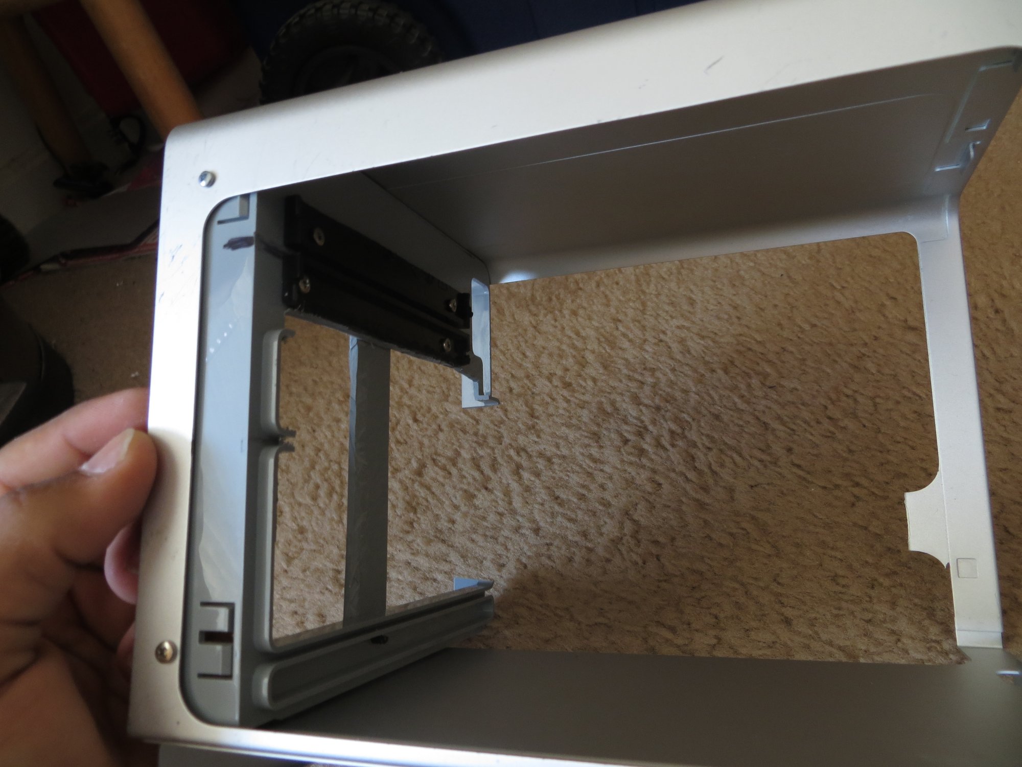

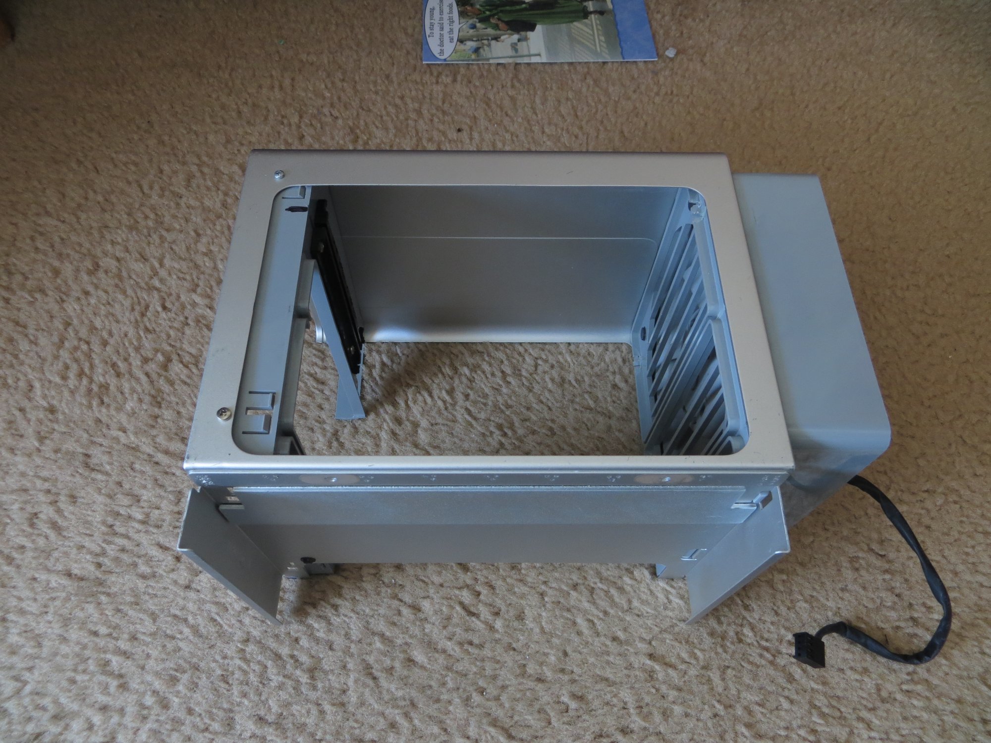

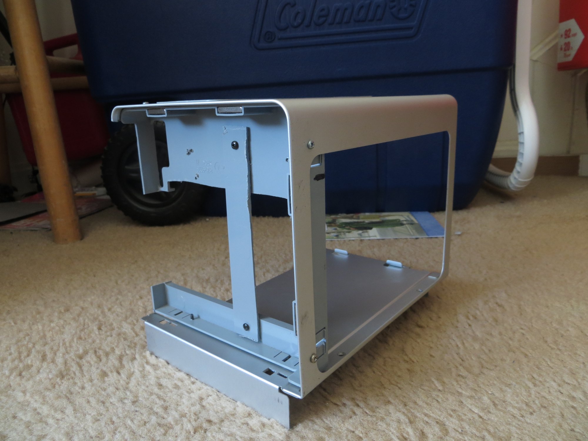

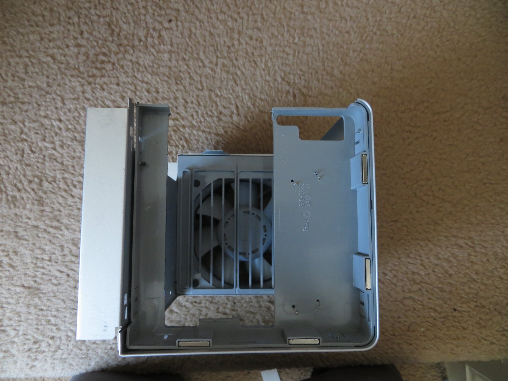

Biggest issues I ran into were from re-using my 1,1's case:
So issues some covered before, some not:
1. 3,1 wiring harness is short. Lugi60 in his posts above outlined how to reuse/modify the original 1,1 harness but I was not feeling quite that brave, so I took the 3,1 harness route. If you use the 3,1 wiring that upper fan bulk head between the optical drive and PSU will mess your day up.
Its thick steel, and I suppose you could grind out the connector holes to allow the PSU wires to thread through it, but I decided to remove it entirely. I would not recommend doing that though, it was a nightmare and ended up with some bent aluminum that thankfully is hidden with the door on. There is just no easy way around this thing ether way. With the bulk head removed I ended up holding the fan in place with some rubber bumpers that came off the floor of the case under the memory cage. It holds very nicely.
2. Its been mentioned before as well, but reusing the original front fan assembly results in a one inch air gap outlined above, regardless if you use the 3,1 or 1,1 CPU cover. Ether replace the front fans or tape the gap/leave it be. The original 1,1 cover does hold on solidly if you decide to skip replacing this.
3. One last big thing that was not nearly bad as that upper fan bulkhead was the memory riser/cage and the logic board standoffs. The 1,1 uses two logic board standoffs marked in red to hold the cage in. The 3,1 uses four marked in green, and the holes don't line up.
To fix this, with the logic board out I just grabbed the standoffs with some pliers and wiggled them back and forth until they popped off. Then screwed the 3,1 logic board into the case. Using an ink cartridge out of an old bic pen I ripped apart, I stuck it through the four holes on the 3,1 board and marked where they were. Out came the logic board again, and this time I very slowly and carefully drilled on those marks four very shallow wells in the outer case wall so as to not go through. Then taking the bit out of the drill, took its sharp edge and gouged the living daylights out of the edges of the new holes to give the epoxy something to hold onto. Since there are only two stand offs from the 1,1 board, I ended up just moving them to the top two holes. Covered the holes in a light covering of epoxy, stuck the standoffs in the mess, and then screwed the 3,1 logic board back down. The new standoffs did not quite line up but with the bic pen cartridge stuck through the screw holes I was able to pull them back inline with where they needed to be and then just let it the epoxy set.
The 3,1 uses a few more logic board standoffs than the 1,1 did, so you will have a few empty screw holes when your done but the only ones that need to be moved are the memory cage mount ones. Also the cage has a screw hole that does not line up that attaches it to the lower base of the case (in the pic above). I just left it, the fronts enough to secure it but it would be easy to drill out the rear hole to fix this.

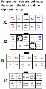

I just successfully converted a 2007 model Mac Pro 2,1 to a 2008 model Mac Pro 3,1.
First, I'd like to clarify what Luigi60 wrote above about the PSU cable wiring. The ONLY difference in the PSU cable socket pinouts on the motherboards between the 2006 / 2007 model Mac Pro 1,1 / 2,1 and the 2008 model Mac Pro 3,1 is in the PS#2 / J2 connector (which is the 10-pin connector in the lower-left corner of the board, near the CPU-B socket). The difference is with pins 4 and 7 (the pin numbers are written on the wires side of the connector on the cable). Pins 4 and 7 are ground wires in the 2007 model Mac Pro 2,1, but in the 2008 model Mac Pro 3,1 pin 4 goes to the 12V1 line and pin 7 goes to the 12V2 line. Pin 4 needs to be connected to the 12V1 pin right beside it (Pin 5), and Pin 7 needs to be connected to the 12V2 line right beside it (Pin 6).
To fix it, I cut the wires coming from pin 4 and 7 (at the logic board end of the PSU cable) about 3 inches away from the connector, sleeved the tips 3" long pieces, then shaved the insulation off of the Pin 5 and Pin 6 wires right at the point where the sleeved Pin 4 and 7 wires would touch them, and then soldered the sleeved end of the Pin 4 wire to the shaved spot on the Pin 5 wire, and the sleeved end of the Pin 7 wire to the shaved spot on the Pin 6 wire. Then cover the other cut ends of the 2 ground wires (we don't need them for anything) and the soldered spots with electrical tape or heat shrink tubing (remember to put the heat shrink tubing piece on the wire before soldering it!)
You do NOT need to do anything to the PS#3 / J3 cable, or buy any new cables.
It's really a lot simpler to do than my description may make it sound. If you have the technical skill to rebuild a Mac Pro with a new motherboard, you can definitely do this cable modification easily.

I've attached a pinout for the Mac Pro 2,1's PSU. The perspective of the image is looking into the plug of the connector on the cable. I've circled the 2 ground wires in cable #2 that need to be made into 12V lines to work with the Mac Pro 3,1's logic board.

Sorry to awake this tread. Can someone explain how would the 08 harness fit into the 06 power supply. Have a working 1,1 MP and a dead 3,1 MP (psu faulty). What would the first procedure be
@MysticIce :
If you are trying to transplant the 2006 1,1 PSU into the 2008 3,1 computer, it should be a drop-in replacement, except maybe for differences in the cable length. The PSUs themselves are the same, I believe.

I "joined" wires 4 and 5 and 6 and 7 so that all 4 pins receive 12V. What I left unconnected were the wires coming from the power supply side that used to connect to pins 4 and 7 on the motherboard.

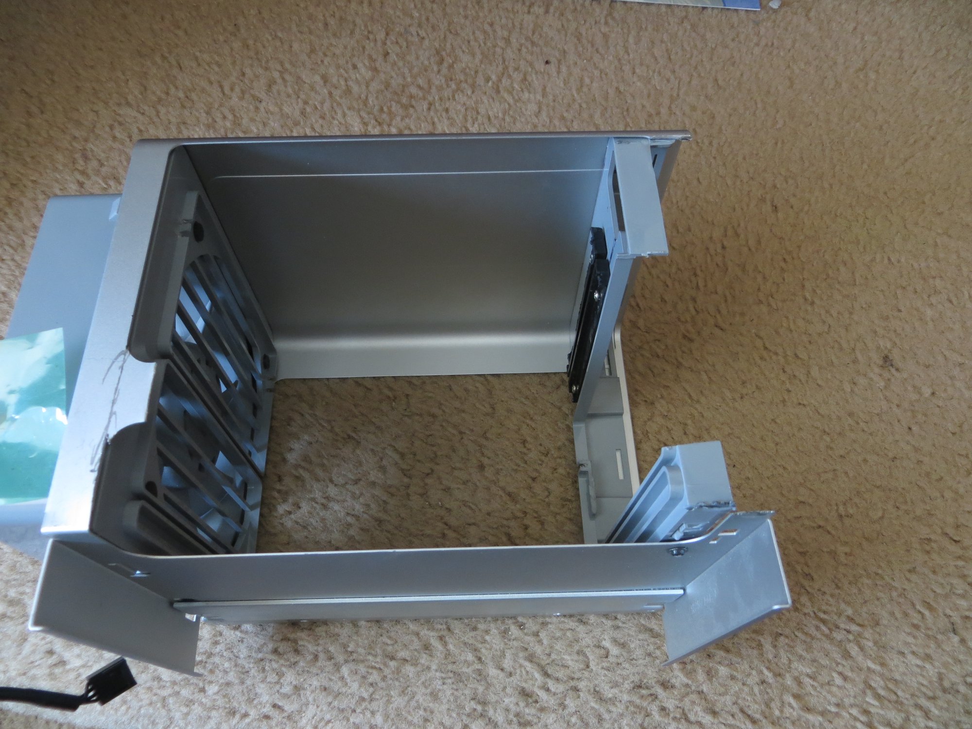

RAM memory card riser: I hacked the old one to work. See the attached pictures.

Your, sir, deserve a beer! It finally worked! Basically you clip #4 and #7 wires and get #5 wire to output to both #4 and #5 pins and #6 wire to both #6 and #7 pins. I get a chime which is much further than I've gotten but none of my graphics cards work with this setup (MSI GT 710, GEForce GTX570 or NVIDIA 7300GT).
I want to report a successful 1,1 PSU swap into a 3,1 machine, using the original 3,1 PSU housing. My 3,1 machine started to power off randomly so I thought I'd replace it's problematic PSU with a more reliable 1,1 one. The only caviat is that I had to solder the original 3,1 power socket because the replacement PSU came without it (only PCBs), but it was a pretty quick and simple. I tought I'd share some pictures because there are almost noothing online to compare against. The cables were long enough and it's pretty straightforward. Some 10 screws and some patience 🙂 The machine works great and doesn't power off anymore. It runs Unigine Heaven GPU benchmark with a Radeon RX570 on a Monterey 12.0.1 just fine 🙂
I'm currently writing this from the upgraded Mac Pro - running OS Catalina with dosdude's patcher.
[automerge]1592919497[/automerge]
To clarify a few things I left hanging in my original post:
Fan speeds: No issue. I forgot to plug in the temperature sensor on the northbridge heatsink and the cable for the PSU fan.
GPU upgrade: I went with a GTX680 for $80. I got a Galaxy brand GTX680 4GB model and reflashed it with EFI-modded firmware. If you're doing this, do NOT get the Galaxy 680 4GB model. It's not listed as compatible in the forum thread for GTX680 reflashing, and although I have it working great in MacOS, if I try to install Windows I get very frequent display glitches and driver crashes.
RAM memory card riser: I hacked the old one to work. See the attached pictures.View attachment 926840View attachment 926843View attachment 926844View attachment 926845View attachment 926846
Did anyone ever try the MP 1,1/2,1 risers on a 3,1 motherboard?
