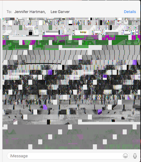

Just put the 1070 back in and getting glitches again. It looks like the glitches actually survive a screen shot - here's what Messages looks like when its glitching:
It's not a failing gpu:
Both the 1060 and 1070 do this in my Mac Pro under OS X. Both are fine under windows. both are fine under OS X when used as epgus on my laptop
