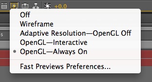

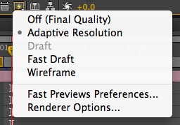

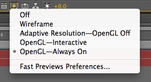

So it only looks that after effects CS5 only works with my ATI card..? Because when i enable openGl the previews are a little faster.. but on CS6 i dont get option.. why?
(CS6 Left, CS5 Right)
