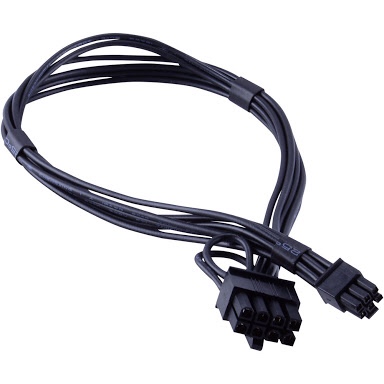

I have a 780Ti in 2 of my 5.1s. I use the 8 pin to mini 6pin cable and the normal 6 to 6 pin direct onto the boards standard connectors. No issues whatsoever on power drain. Why do u want to tap into the optical bay power? Are there any other gpus connected to the standard mini pci connectors on the board?
Here's the type of cable u need for the 8pin
I only asked about the optical bays because i have seen others advising against using a 8pin-6pin cable due to the power draw being too much for those ports to handle (Apparently the 8pin connector can draw over 75w which is what the 6pin port only provides), I've also seen people say it works for them (like it does for you it seems), so i havent found any rock-solid info on this i guess (some say it works, like you, some say it doesnt, some just say its risky) so i was thinking if i tapped into the optical bay power bays i wouldnt need to worry
If you do that because you want everything stay within limit. You can use:
1) 2x SATA (~110W avail) -> 6 Pin (75W)
and
2) 2x mini 6pin (150W avail) -> 8 pin (150W)
If you use 2x SATA (110W) -> 8pin (150W). You may accidentally kill the SATA ports (depends on you 780Ti's actual power draw).
