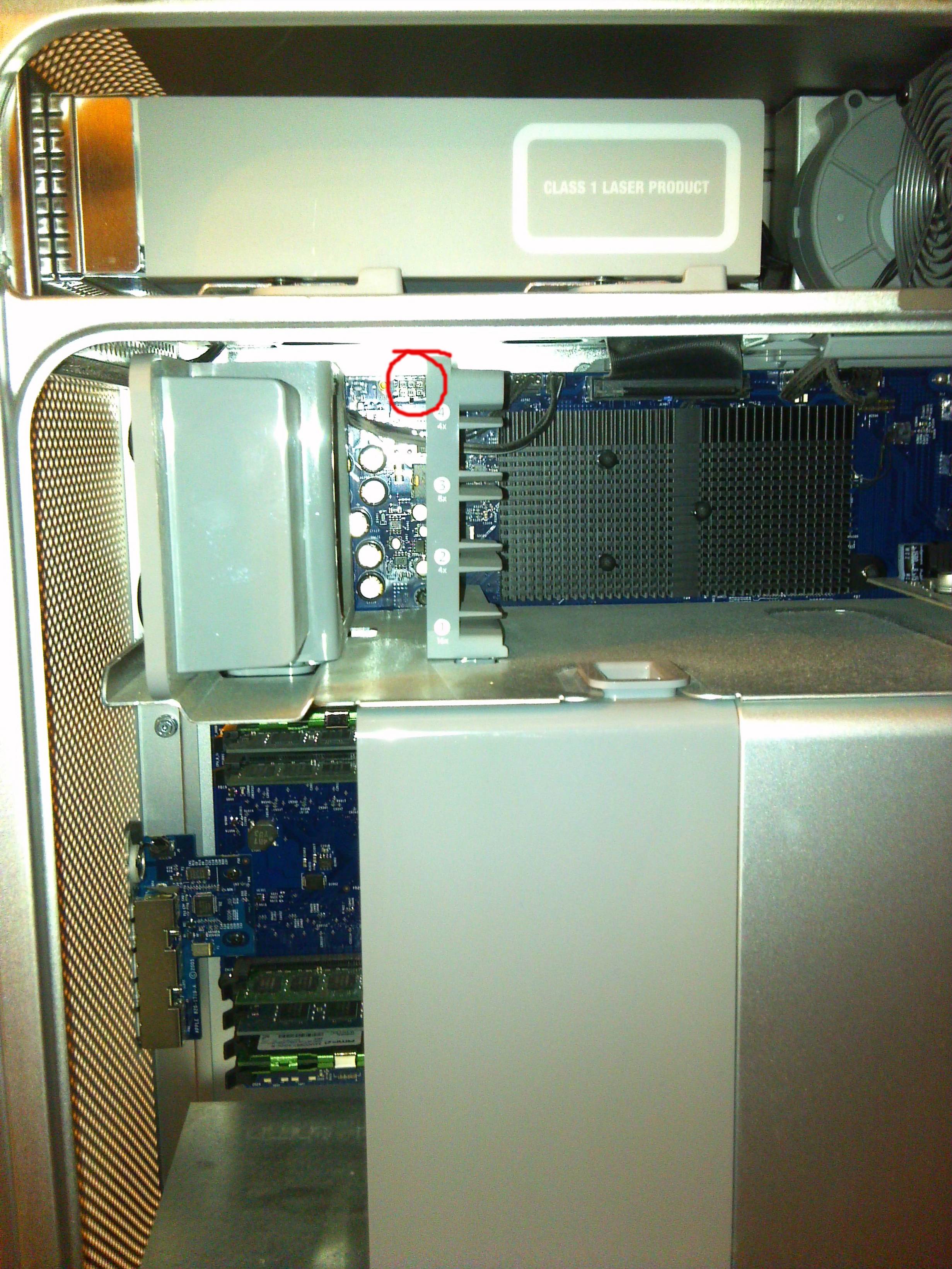

Well I have changed the 7800GT card for a Mac Nvidia Quadro fx4500 256MB PCIe card.
It came with a power cable, so before I even open the case do I need to connect the power cable and to were.
The old 6600le doesn`t have a power cable, just connects through the PCIe slot.
The power cable needs to be connected that came with your video card as the PCIe slot does not have anuff power by its self for the card. Sadly i never had this video card so i have no idea wear the power cable goes🙁 i did see a photo of a G5 Quad with this card once and i think it connected some ware on the motherboard under the Hard drive bay but i am not sure🙁
It plugs in where I circled in red. 😱
