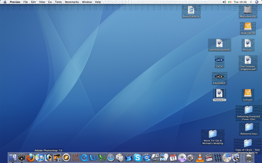

Hi, first timer here! I'm wondering if anyone can be of assistance. My display on my mac's gone weird. I've attached a snapshot of the screen. Here's a breakdown of the symptoms:
* Firstly, it just happened out of the blue the other night, the screen saver was doing it's thing and when I returned to the computer this is what I saw.
* It's slightly intermittent, but the weirdness is present 98% of the time.
Visually -
* It affects the mouse
* It affects the dock
* It affects any pop ups e.g. the "do you want to quit or save and quit" pop ups.
* It affects my photos in iphoto
* It affects the artwork in iTunes, but nothing else
* It affects the bar across the top of the screen
* It doesn't affect photoshop
* It doesn't affect the internet display
* It doesn't affect Pro Tools
Apart from that, so far, everything functions as normal.
Here's my machine stats:
OS X v10.4.11
Machine Name: iMac G5
Machine Model: PowerMac8,2
CPU Type: PowerPC G5 (3.1)
Number Of CPUs: 1
CPU Speed: 2 GHz
L2 Cache (per CPU): 512 KB
Memory: 1.5 GB
Bus Speed: 667 MHz
Boot ROM Version: 5.2.5f1
ATI Radeon 9600:
Chipset Model: ATY,RV351
Type: Display
Bus: AGP
Slot: AGP
VRAM (Total): 128 MB
Vendor: ATI (0x1002)
Device ID: 0x4150
Revision ID: 0x0000
ROM Revision: 113-xxxxx-117
Displays:
iMac:
Display Type: LCD
Resolution: 1440 x 900
Depth: 32-bit Color
Built-In: Yes
Core Image: Supported
Main Display: Yes
Mirror: Off
Online: Yes
Quartz Extreme: Supported
Thank you and kindest regards,
Andy.

Hi Blue Revolution, thanks for taking an interest in my case.
I followed your instructions and logged out and logged in to another user's account and then back again - and for a while I thought that those actions fixed the problem as the screen returned to normal for about 20 minutes. I then left the computer for a half hour and came back to find that the screen saver had kicked in again. So I moved my mouse which brought me back to the desktop again, only this time the problem was back. I then logged out and into another account and the problem was still there!
Yes, the problem is persistant, it's there for most of the time that the computer is on, only very rarely will it return to normal.
Any ideas? Thanks again.
Andy.

I just "hoovered" the vents in the computer and what do you know?! The problem is fixed - no more graphics problems - crystal clear!
Thanks again for all your help...🙂
That's why it was OK for the first 20 minutes; it took a bit of time before the heat became a problem.
