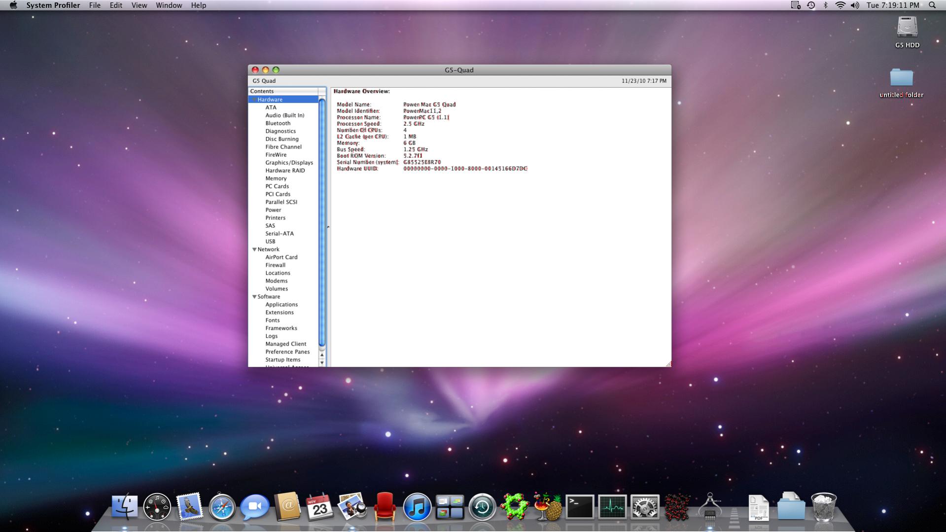

Well I was swapping some processors around on my G5 when I noticed that I was getting some weird graphical glitches. They went away when I disabled the 3-4 CPUs and made it a dual-core. The glitches are replicable when sizing windows and consistent when different window sizes. I'm starting to wonder if one of my CPUs are faulty...? Everything seems to be running fine otherwise. I attached a pic of the graphic anomaly I'm getting with all 4 core active and it only appears around text and it's always red color.
On a side note I also noticed that 2 of my dimm slots are reporting errors, the two outer banks. I've removed them and it's fine. Gonna load up the diagnostic discs to see if it finds anything.

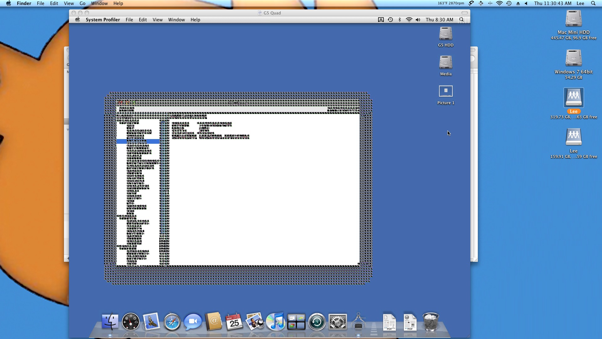

I will try that as I doubt that is the culprit in my case. I've already reinstalled the OS and removed the graphics card and used screen sharing so this is definitely not the graphics card. I uploaded a screen shot while screen sharing.
Guess I'll try and reseat the processors or swap them around. This is such a hassle 😛
I also need to see if I can find other memory to see what's going on with the outer memory banks as maybe this is the cause of the graphics distortion? Guess I'll keep everyone posted with updates.
