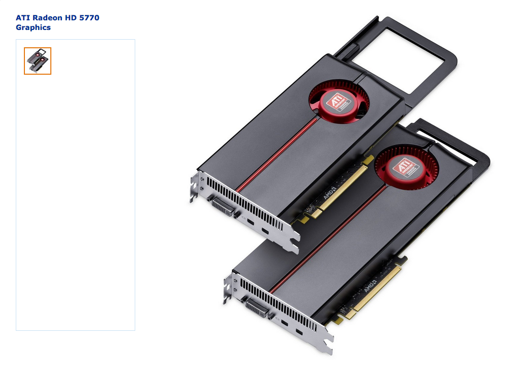

sorry about that, I only asked becase my 5770 has only a single DVI + 2 MDSP.
