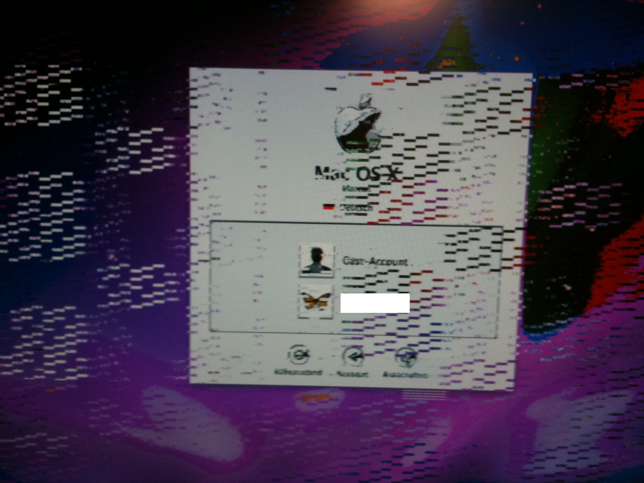

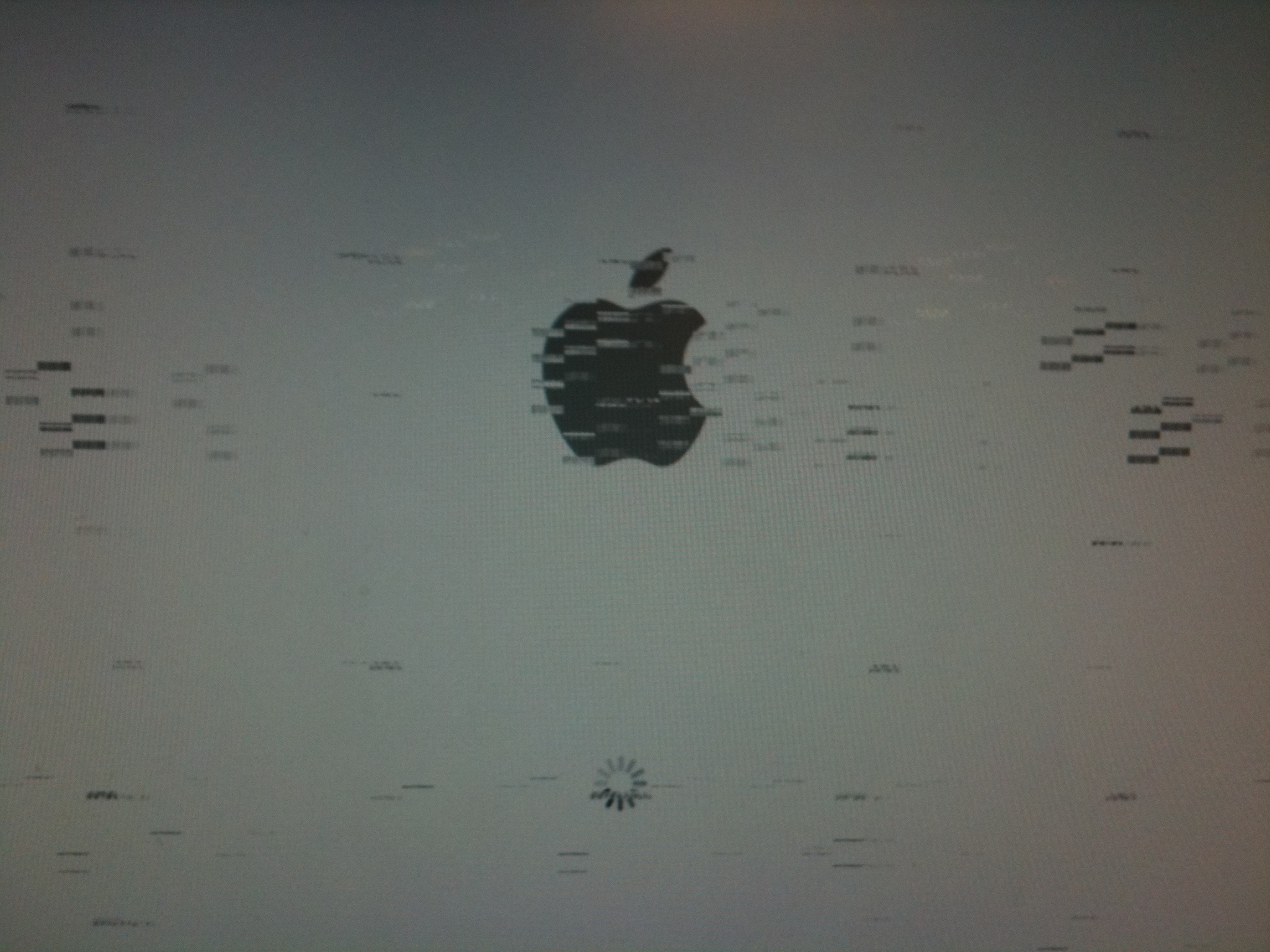

ok I have this issues:
is the graphic card broken? Or is the mainboard broken?
Any suggestions?

Dead GPU. The 8800 cards were pretty much all defective. If you're still under AppleCare, get the card replaced.
GPU replaced
ok gpu was replaced (Apple Care)
now working without any issues 😀
Apple Care is worth the money (2nd repair of my Mac Pro in 2.5 years)!!!!
first repair was logic board, second repair was gpu
I hope this was my last repair of my Mac Pro, because I only have 0.5 years of Apple Care. 🙄
