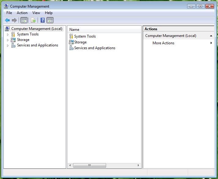

You're right, I hadn't tried that! Looking just now though I can't see the Local Users and Groups tab you talked about. Am I being blind +/- stupid?
Open up a command prompt and type:
net user administrator /active:yes
This should enable the administrator account.
