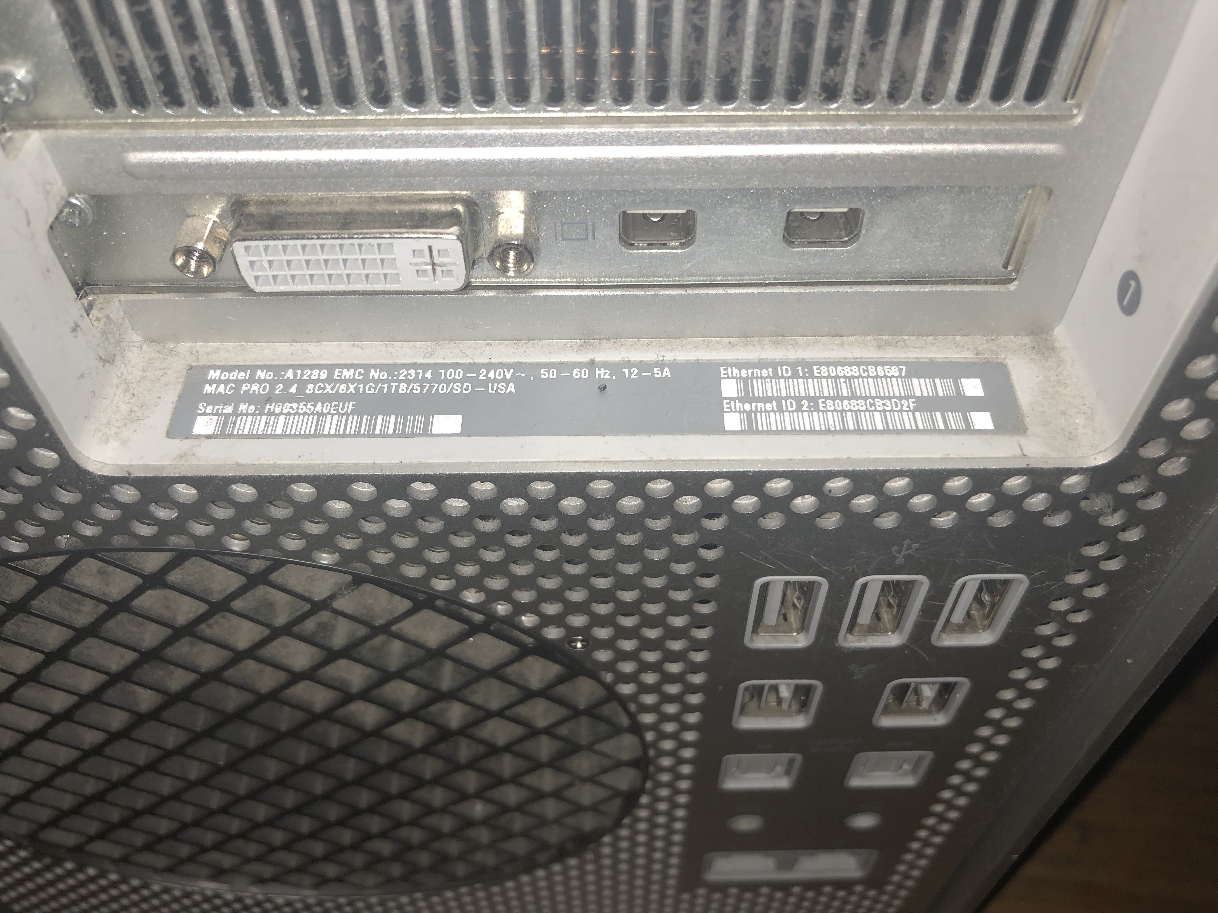

Hi there, thank you. I’ll will try that but before I do I thought I would pass on the info of the computer that I found. It’s an old desktop, picture of info below:

[doublepost=1531256490][/doublepost]View attachment 769953

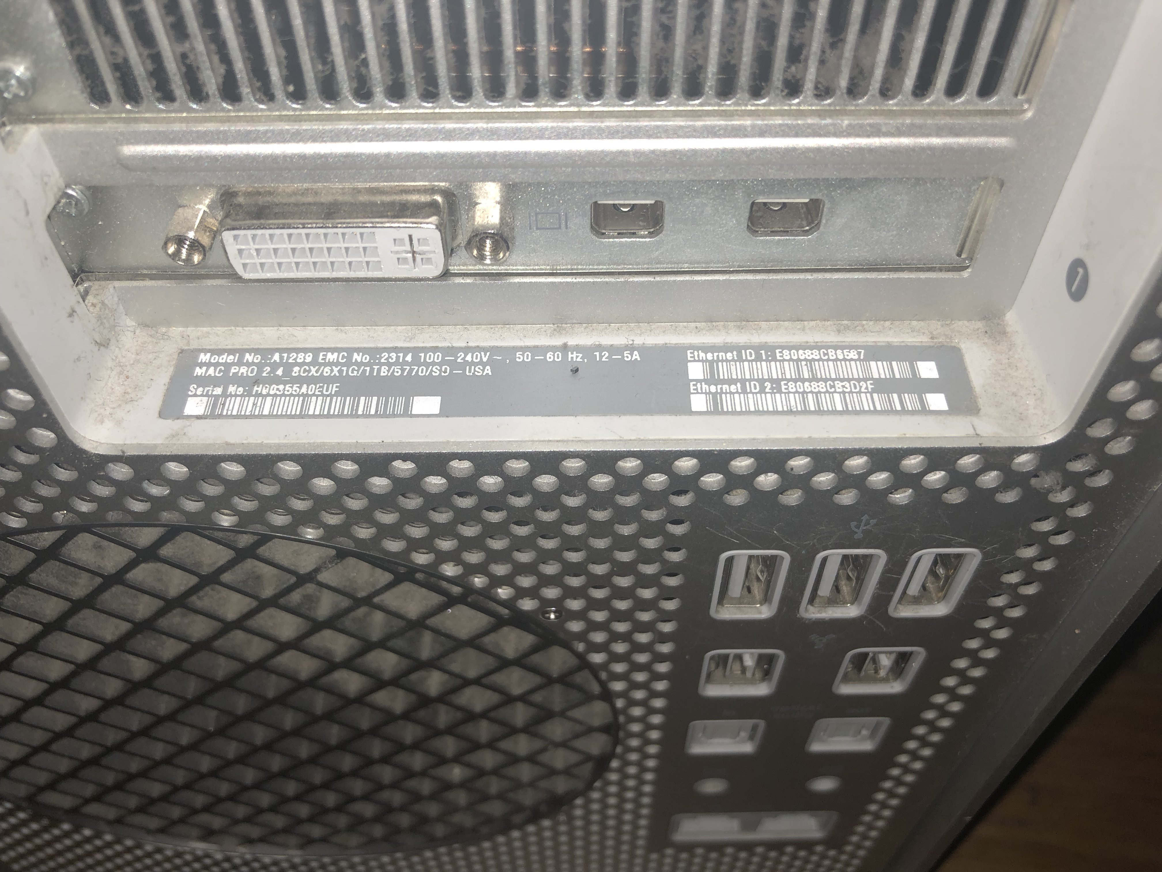

Okay then, on the image is the info I asked you for: MacPro 2.4
As @z970mp pointed out it is most likely a 2010 model, meaning that it came with Os X 10.6.

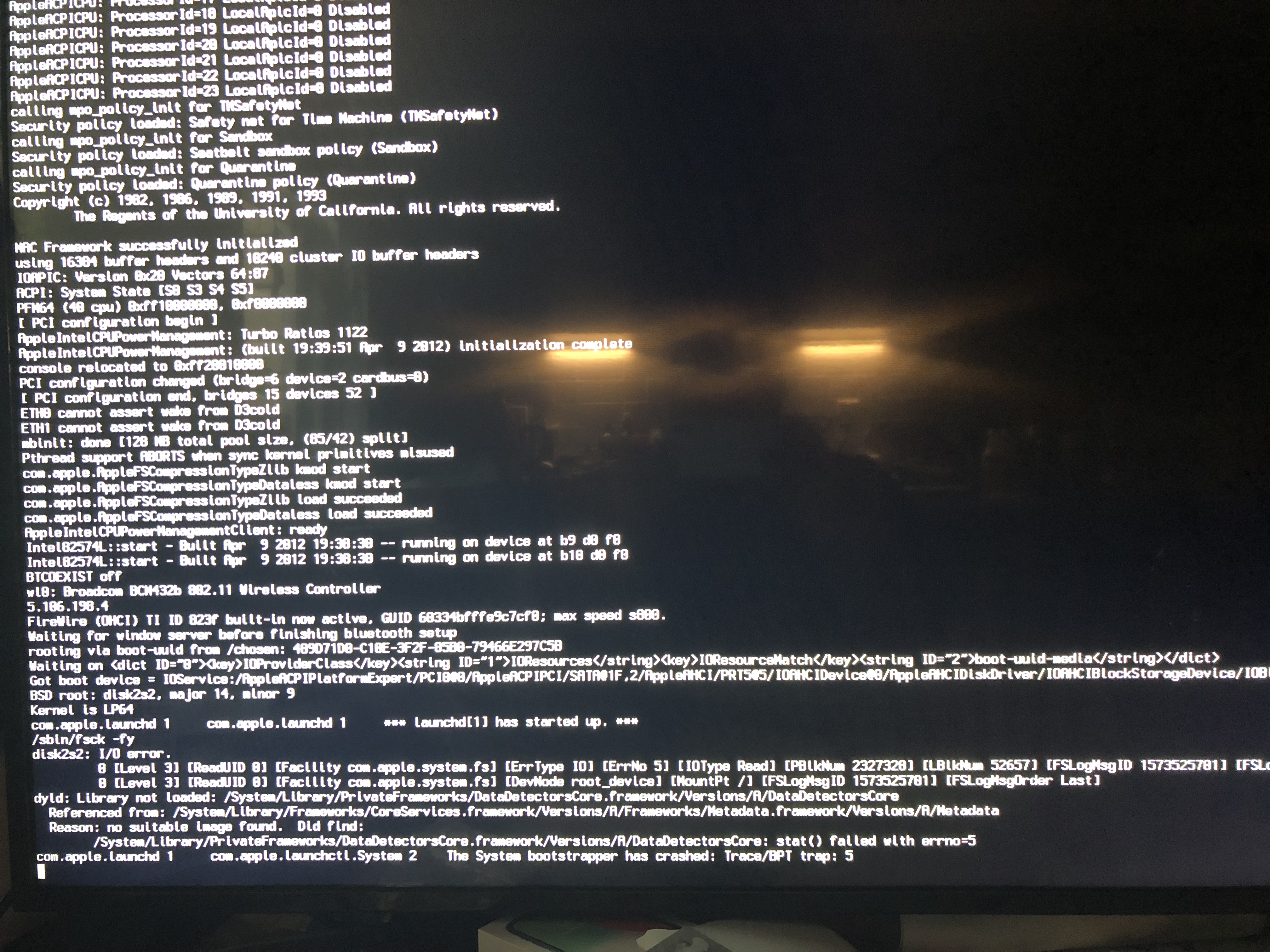

Hi there, I did, I also tried the control S and got this message:

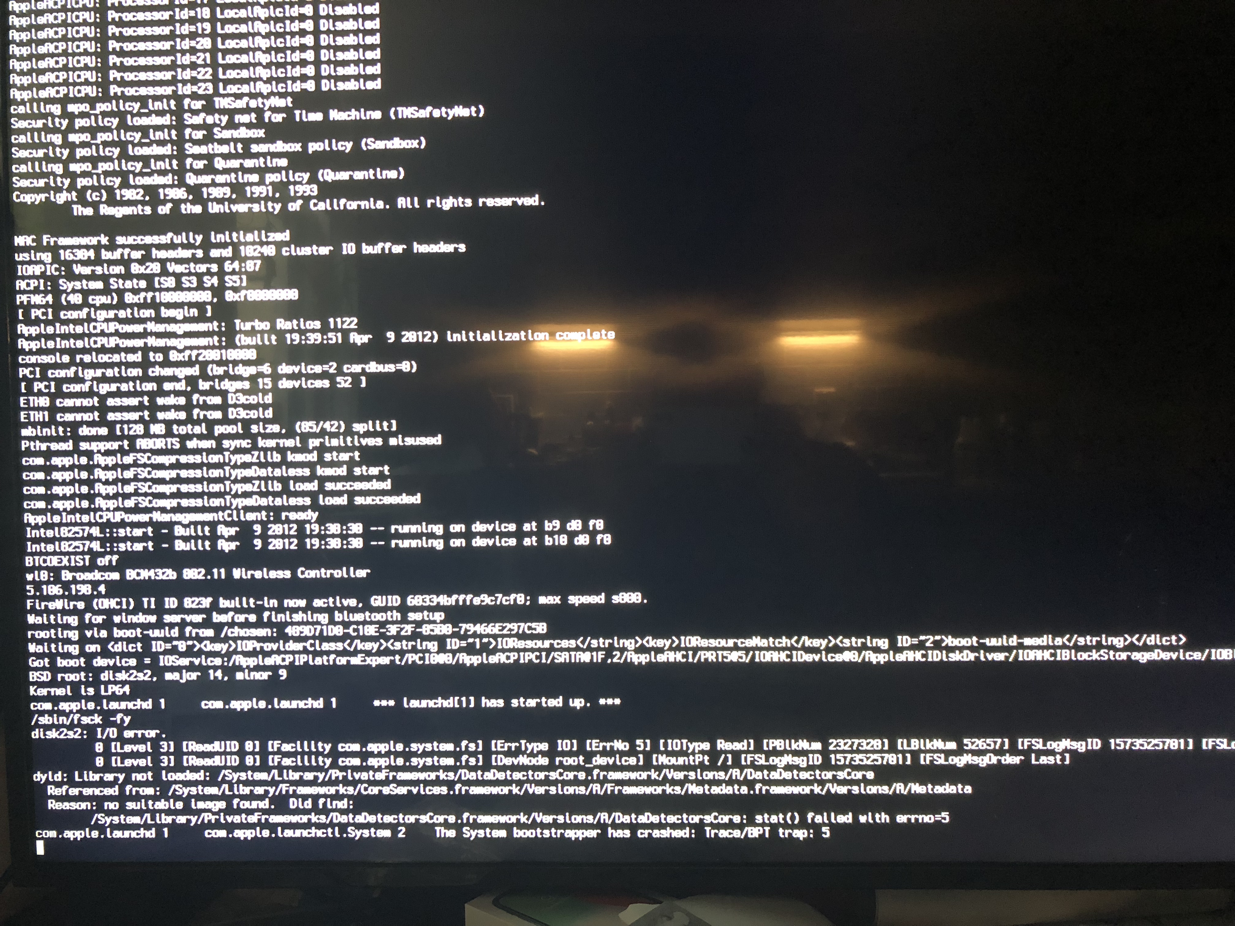

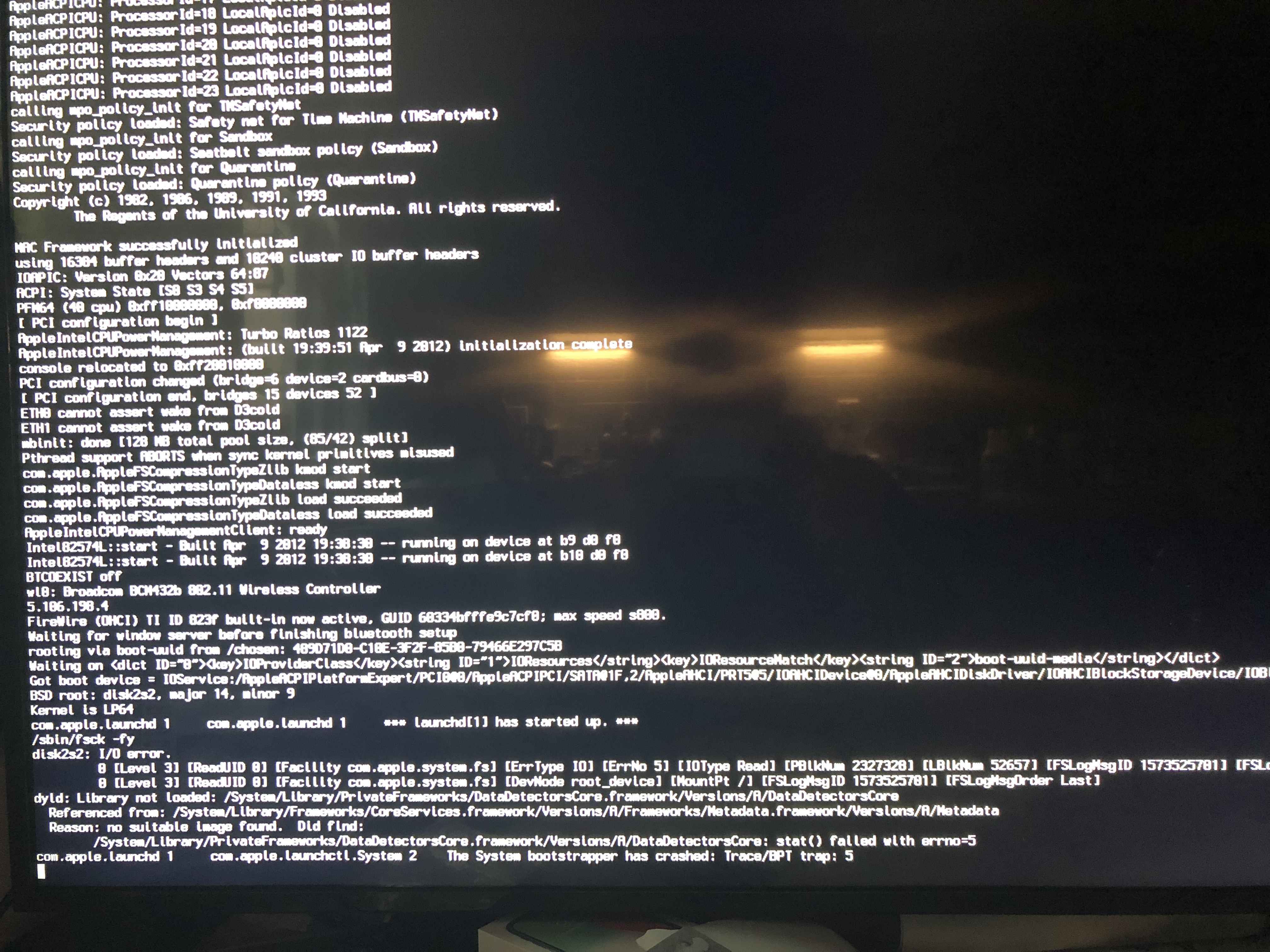

Hello! Thank you. I tried but didn’t get the “your drive is okay” message, I don’t think. I got this:
