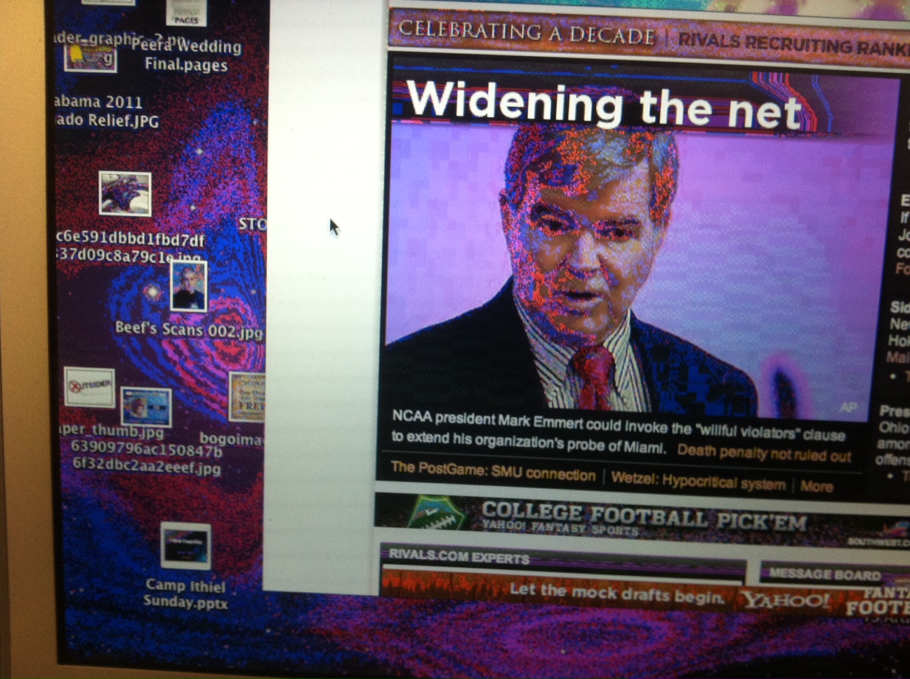

The other day, I went to start it up and it froze on the gray screen with the apple logo. I had to hard-restart it. Then after a few times of that, it allowed me to log-in and operated fine for a bit. But suddenly, it did this weird thing with the screen where it looks pixelated and off-color and froze up. It wouldn't let me do anything. Attached is a picture.

My guess is it's a video card or RAM issue. I've seen the same pixelated effect in external LCD screens if the sharpness adjustment is off in the monitor - but that's probably not the problem here as you said the screen froze when it happens.
To test if it's a RAM issue - try using just one ram module at a time. Then run Apple's hardware test if you are able to get it to boot again.

You may fall under the nVidia 8600GT recall if you have that GPU in your computer, I would check through Apple.
