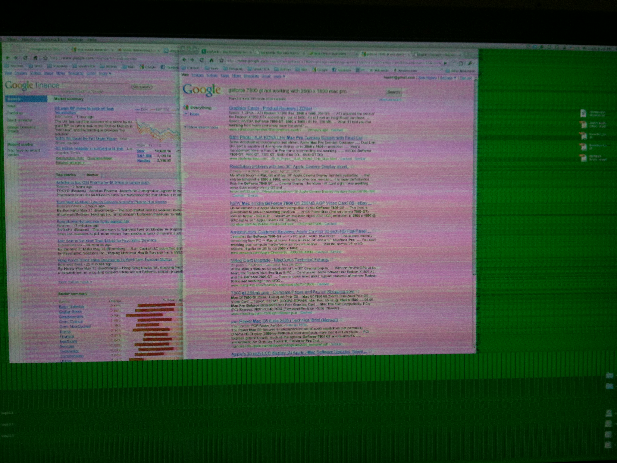

I own a MacPro1,1 that has a Geforce 7300 GT running on it. That video card comes with one Dual-Link DVI port, and anonther that is Single-Link. I just bought a Dell 30" 3008WFP monitor that has a max resolution of 2560x1900.
When I first connected, it worked great. I was getting the max res; life was good. Then I started getting this random green fuzzy screen that would come and go at whim. I couldn't reproduce it, and worse was I have not figured out a way to get rid of it. Early on, just unplugging and replugging in the cable worked. Then that stopped working. Rebooting stopped working. Once i was able to get the green to go away by powering down the display and powering it back up. Yes, totally random.

5. I've attached a screenshot of what this looks like.
Anyone's help would be greatly appreciated. I don't know if this is the video card or the display.
Make a "real" screenshot (cmd-shift-3) and have a look at it on another computer/display. If it shows the colour distortion, there's something wrong with the graphics card, otherwise it's the display that's faulty.

Flatfoot, I tried what you said and the screenshot showed up without any distortions; just a normal screenshot. Is that enough to conclude its the display though?
no, but enough to conclude it's not the graphics card.
what you are looking at is a problem somewhere after the signal is sent by the graphics card. so either, graphics card port, display cable, monitor port, or monitor itself.
