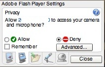

You might also look at Activity Monitor to make sure the iChat or Photobooth processes aren't running. Even though you don't see them on the Dock, the process could still be active. Occasionally, apps don't shut down properly. Also, there are flash settings that can affect your camera, if you've given flash the permission to access it:
