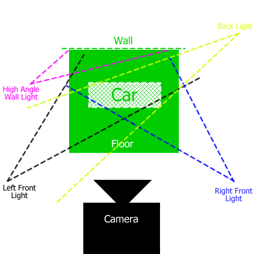

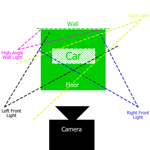

i suggest two lamps from the left and right a little bit higher than the car. i would also recommend a back light from the right side going across the car to the near left and finally, if needed, a light on the left side aimed at the green to dispose of any different colours. The light on the green screen needs to be done carefully though as if the light is too strong the backdrop will have a white/lighter patch. I would recommend doing this from a high angle at a bit of a distance.
If you need a picture, im sure i could draw one up for you at some point today 😀
Hear you go, this should help you out a fair bit.

Btw thanks alot for info, especially you tri3limited for the diagram pic.
