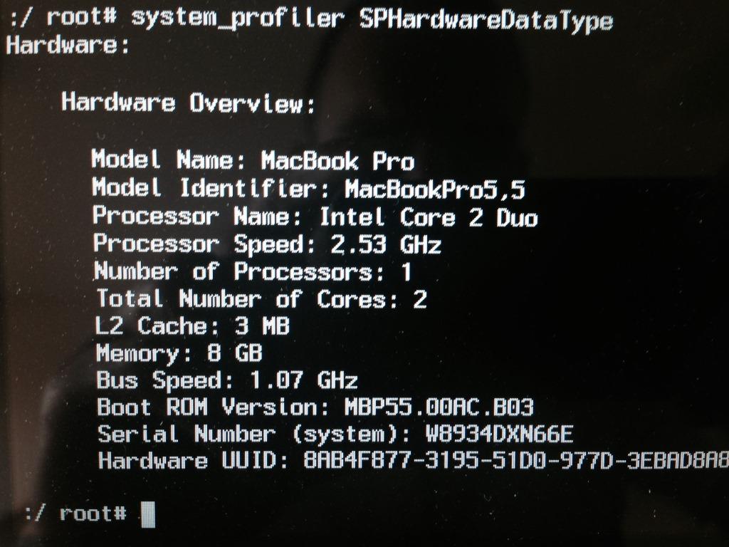

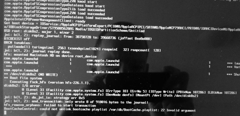

I have a Macbook pro unibody 2009 that gives me the grey screen of death.
I have done a number of checks to try and understand what's wrong, but more importantly, running it in recovery mode, it does not want to restore the Time Machine I have on an external hard-drive ("An error has occured while erasing your restore destination disk"), nor do an OS X reinstall ("an error occured while preparing the installation")...so I am at a loss...
please see pictures for more details on machine and where it stops when starting in single user mode...

It seems you got an I/O error reported by fsck, which does filesystem consistency checks. So either your filesystem or disk is has a problem I think.
...but given in recovery mode in disk utility I can currently actually "scan" all the content on my HD, I figured the cable must be fine...
Have you tried to test the file system with disk utility, if so does it report the filesystem as OK? If not, have you attempted to do a repair on the filesystem on disk0s2 with disk utility? Just some thoughts.
Yes, I ran a file system verification and repair but it found nothing.
I occurred to me that is says (NO WRITE) after the device node, so the file system is likely mounted read only, which may be why fsck fails. You can see that it wrote 0 bytes to the journal below. You could perhaps try to mount it read/write and run fsck_hfs again, but take care since you're root.
Edit: I just saw this, http://support.apple.com/kb/ts1417 which advice against fsck for versions above 10.4, perhaps you can try the safe mode boot that is suggested in the document if you haven't already.
Ah! That is well spotted, thanks mate!...how do I remount it in R/W? In disk utility? Feeling a bit in unchartered territory here...
I was referring to while in single user mode. You should be able to check if it's mounted read only with:
