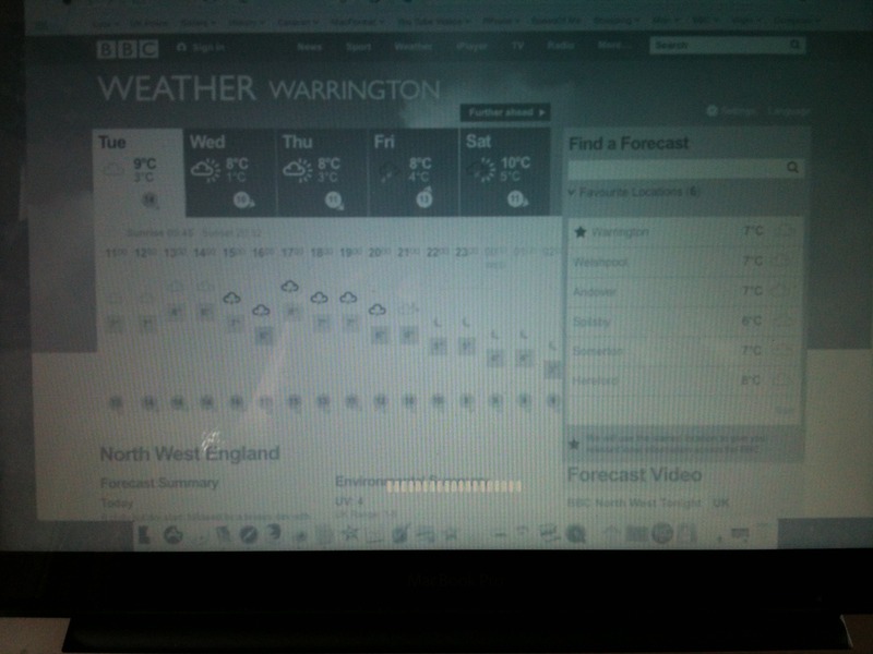

Every now and then, as I open the lid of my MBP to wake it, the Superdrive makes the normal power on noise, and the screen comes up as shades of grey, and a "progress bar" in the form of white dots appears.
It can take up to 3 or 4 minutes for the screen to get back to normal, and another 3 or 4 minutes to get control back; ie, keyboard and trackpad.
Has anyone else come across this? it used to happen with my old White MacBook as well.
