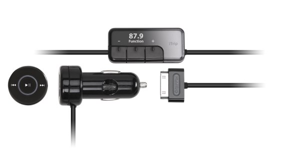

FWIW, mine works well: it’s a Griffin "iTrip AutoPilot with SmartScan." (3-in-1 Charger, FM transmitter, and playback controls.) Occasionally when I first plug in, it pops up a message about not being compatible—but when it happens I ignore it and everything works. My iPhone 3G did the same thing anyway.

It looks like that, but I’m not 100% certain: mine has playback controls on the charger plug, and I think Griffin made a similar product that lacked the controls. Mine is called AutoPilot, so I wonder if this one named just “auto” might lack the controls. In any case, the radio box looks the same.
Here’s mine:
Here’s my part number FWIW: 4046-TRPAUTOC.

Got my iTrip from the ebay seller I listed above. It doesn't have controls on the power adapter itself like nagromme's. Otherwise it seems to be the same. I've used it for 2 15-20 min car trips and it works great so far. I didn't use smartscan and just set it to the 107.9 from my previous fm transmitter and it sounds pretty clear (much better than my previous one) and it does charge my iPhone 4. Little static or noise unless I crank up the volume really high. There's a few quips (listed below) but overall I'm very happy with it. Especially for 16 bucks.
