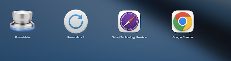

Powermate 2 work well under Ventura.
Reactions: Flint Ironstag
Hi Mark.g4
Thanks for your help. it's going pretty well at the moment. Sometimes when you restart the Mac you have to restart the process in the system settings, but then it works again. I can live with that. PS What does the logo to the right of the PowerMate button mean? Kind regards Matt

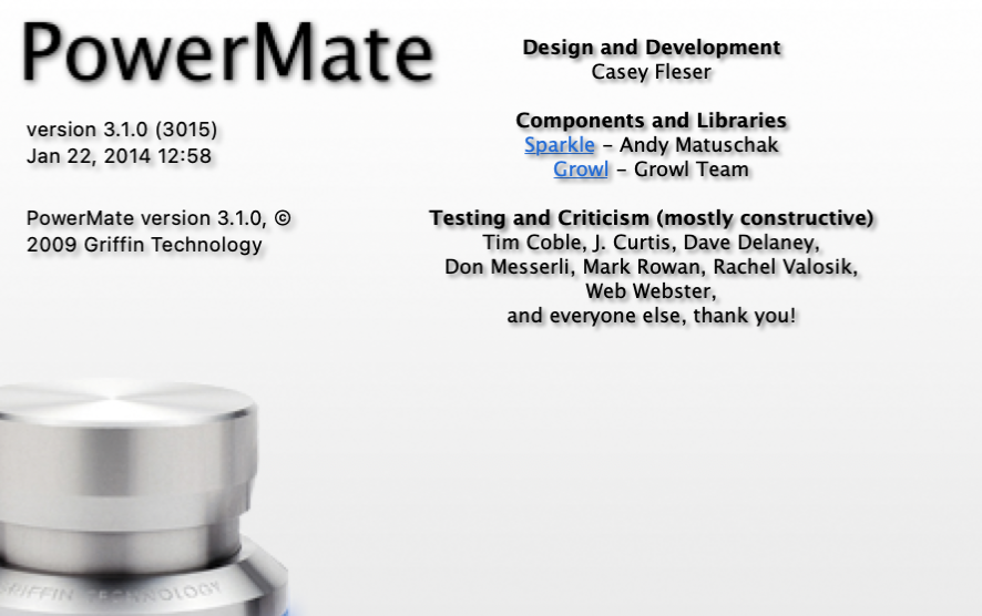

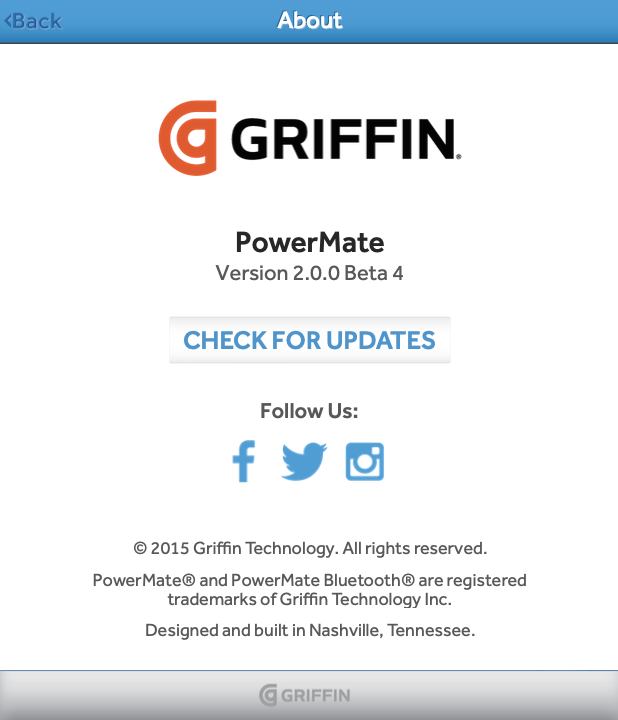

Did they actually roll back the version number? Because I have a much older 3.1.0 app and it's either from 2009 or 2014; but judging by the icon and also some googling it seems this version 2.0.0b6 is from 2017?

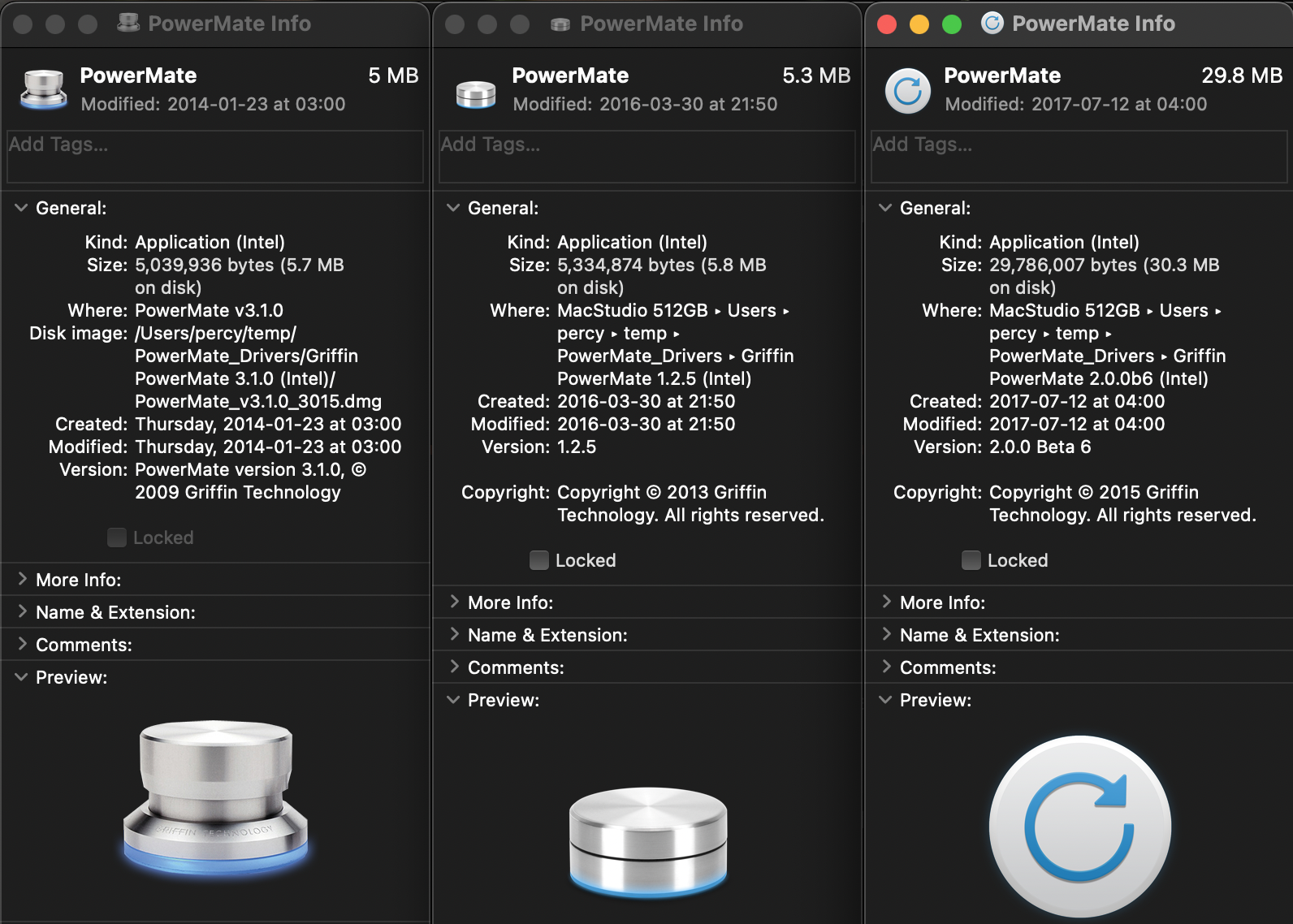

I dug out 3 different version of the PowerMate app coming from different eras of supported OS X.
Apparently they rolled back the version number at some point, so 3.1 is actually older than 1.2.5....
I should add that in Monterey and Ventura, I actually got the oldest 3.1 working right away. So I stick to using this version without bothering with the newer ones.
Thank you for posting those drivers and explaining the differences.
