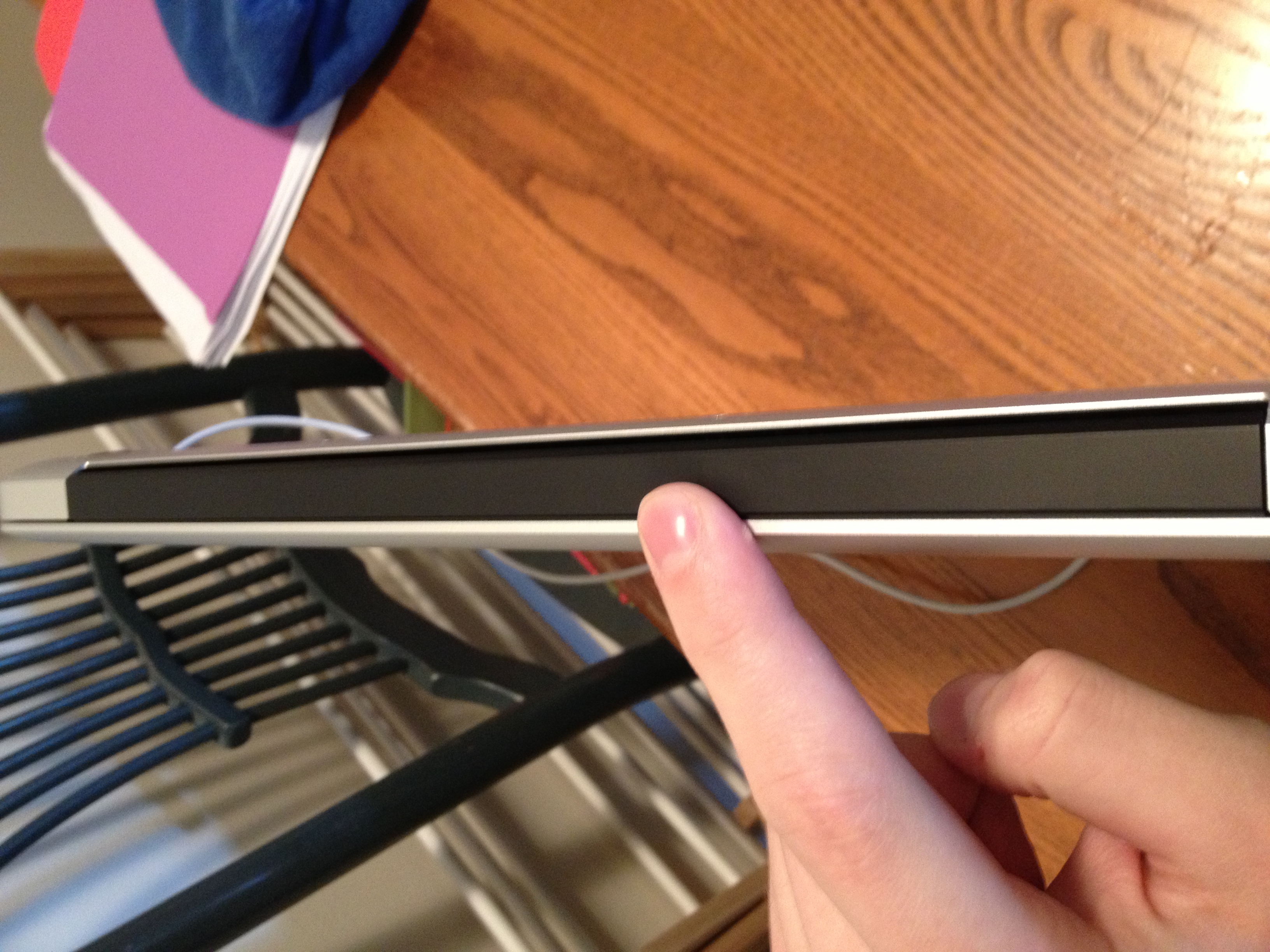

Do you mean the little black thing at the back? Mine has a gap (2mm) and when i press on it, it cracks and moves, also making me hold it on the other side.
Yes. This thing. It moves from left to right randomly. Mostly when you have your hand covering it while carrying it.
