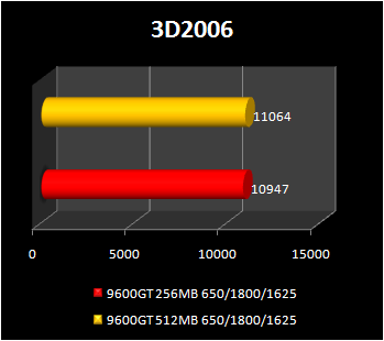

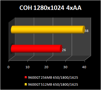

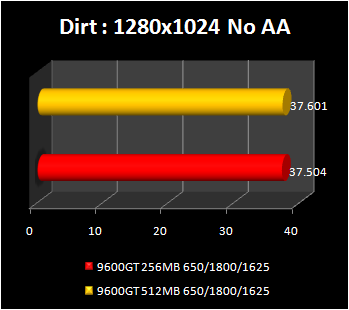

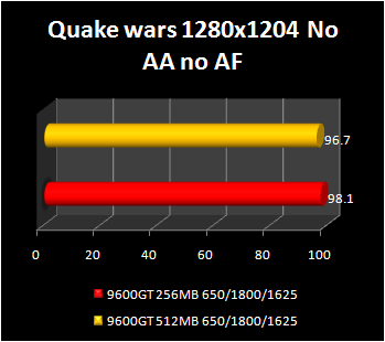

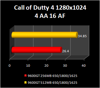

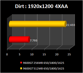

I know the 330m is comparable to the 9600gt. Lets have a look. I couldn't find any at 1440x900 but here are some various resolutions. See how on certain games the 512mb version performs better in benchmarks.

Haha, not only that, but the benchmarks are all using different resolutions, all of which are beyond what the macbooks can even display. Hell, the one benchmark was done ABOVE freaking 1080p resolution.
If you were to run some games at those resolutions on the new MBP, your difference would be 1 fps since it would only be running at a couple fps anyway.
I compared both 1280x1024 and 1920x1080. One is lower, one is higher. Actually 1280x1024 isn't that far off from 1440x900. I even pointed out in that post that they aren't native 1440x900 but should give a good idea.

I just noticed your benchmarks use anisotropic filtering and anti-aliasing. That is a method which involves using up to 4 times the texture resolution of the original texture, and again has nothing to do with screen resolution.
From the same web page that you grabbed your benchmarks:
With AA & AF off, there is virtually no difference at all.
