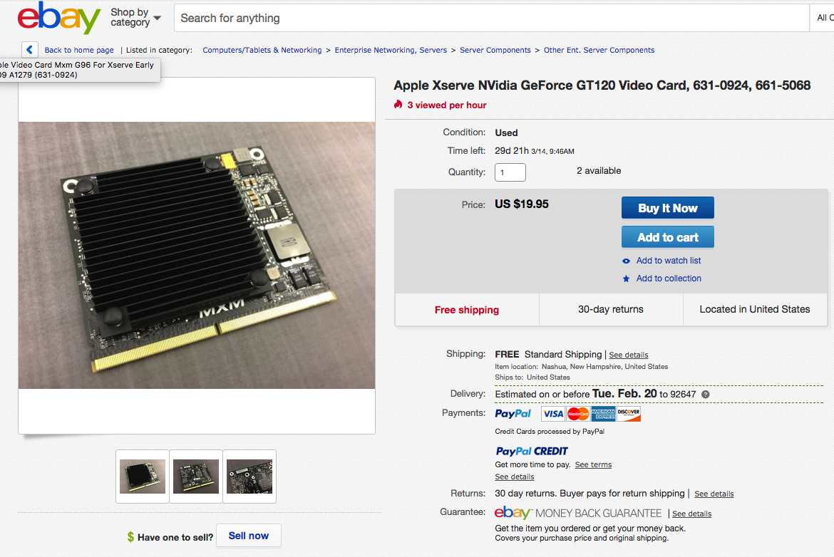

Xserve version....

doesn't look like can plug into the cMP's PCIe slot.
No, it won’t. It’s an MXM version, like what you’d get in a notebook with dedicated graphics. It’s mainly just to see how big of a passive cooler I’d need.
That product would take the MXM card and allow you to use it in a PCIe slot. A neat idea, but a bit beyond what I’m looking to spend for this project. 🙂

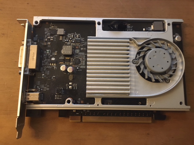

Tried an experiment where I removed the plastic shroud over the GT120 and unplugged the fan. The aluminum cooling frame is actually quite substantial, though not all of it is centered around the GPU die, but there is a set of fins over the GPU itself. Next, I loaded the GPU with Luxmark, which is likely beyond what I would attempt in normal use. Temps slowly rose from the 50s up to 75C before I ran out of time and stopped the experiment, and the heat sink got pretty toasty. NVIDIA lists the max temp of the GT120 at 105C, but I’m not sure if I want to push such an old card. I may look at getting some extra airflow over the existing heat sink.

I did move it to the second slot--great minds think alike! I also engineered a shroud to pick up more air from the PCI intake fan. I cut a wedge out of an old plastic mouthwash bottle (recycling). I can use Macs Fan Control to monitor "PCI slot 2," which appears to be the GPU reading straight off the GT120. The GPU appears to idle higher in MacOS than Windows 10, but it hovers around 60C most of the time now. Loading it down pushes it up to about 70C. If I manually turn the PCI fan up to 3000 RPM, I can get the temps down to 53C, but that's pretty loud. If I set the fan range to 58C to 80C, temps seem to manage well for now. So far I can't get it back to 70C for my use. Not anywhere near the 105C thermal limit so far!
I'd say we have success, but we're still in the winter months here. I'll be working against higher ambient temps in 2-3 months. Still, I feel better about the extra air flow over the card to keep the heat from building up.
