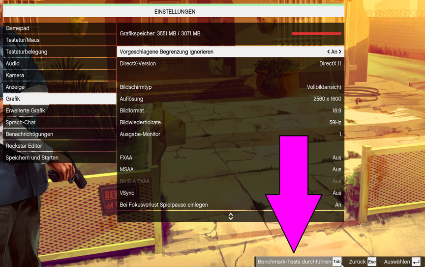

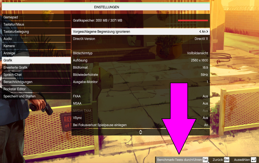

Franklin mission now completed, so i could do the benchmark (-> settings -> graphics, bellow you will see 'Benchmark')
The result can be found here: C:\users\username\documents\Rockstar Games\GTA V\Benchmarks
Config: Mac Pro Xeon W3690 @ 3.47GHz, 49152MB RAM, NVIDIA GeForce GTX 680, 2088MB, Driver Version 350.12, 2560x1440, VSync OFF, Long Shadows On:

Graphics Card Vendor Id 0x10de with Device ID 0x1180
=== SETTINGS ===
Display: 2560x1440 (FullScreen) @ 59Hz VSync OFF
Tessellation: 2
LodScale: 1.000000
PedLodBias: 0.200000
VehicleLodBias: 0.000000
ShadowQuality: 2
ReflectionQuality: 2
ReflectionMSAA: 0
SSAO: 2
AnisotropicFiltering: 16
MSAA: 0
MSAAFragments: 0
MSAAQuality: 0
TextureQuality: 0
ParticleQuality: 2
WaterQuality: 1
GrassQuality: 1
ShaderQuality: 2
Shadow_SoftShadows: 2
UltraShadows_Enabled: false
Shadow_ParticleShadows: true
Shadow_Distance: 1.000000
Shadow_LongShadows: true
Shadow_SplitZStart: 0.930000
Shadow_SplitZEnd: 0.890000
Shadow_aircraftExpWeight: 0.990000
Shadow_DisableScreenSizeCheck: false
Reflection_MipBlur: true
FXAA_Enabled: true
TXAA_Enabled: false
Lighting_FogVolumes: true
Shader_SSA: true
DX_Version: 2
CityDensity: 1.000000
PedVarietyMultiplier: 0.800000
VehicleVarietyMultiplier: 0.800000
PostFX: 2
DoF: true
HdStreamingInFlight: false
MaxLodScale: 0.100000
MotionBlurStrength: 0.000000
