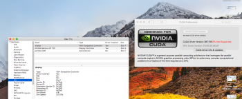

Doesn't look like the driver installed completely. Several people have had that issue including myself.
Under System Info it say's No Kext Loaded.

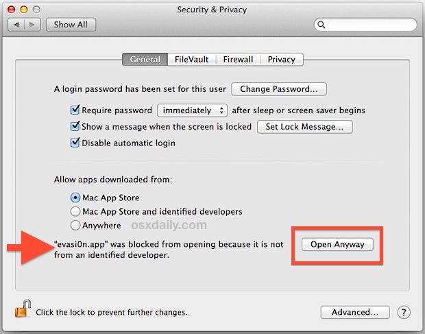

Leave SIP and Gatekeeper enabled.
Re-install the driver and during the install when it pauses, go to Security & Privacy system pref and Allow the kext to be installed.
If your HS install has had all updates available you should be installing:
Web Driver: 387.10.10.10.30.107
CUDA Driver: 396.64

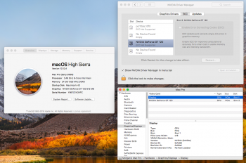

When it's installed correctly your info should look like this:

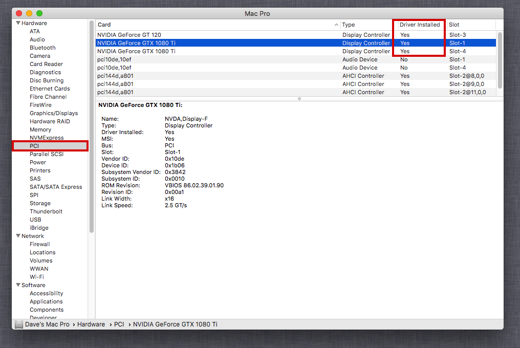

And under PCI Info you should see the driver is loaded when it's installed correctly.

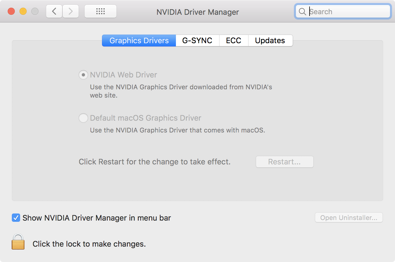

That's another thing that causes confusion. The "NVIDIA Driver Manager" Preference Pane installed fine, the installer installs that first. But then when it tries to install the actual driver, the .kext file, it was blocked. Having the NVIDIA Driver Manager pane does not mean the actual driver is installed.

What does your PCI Info show ? Driver Installed ? Yes or No ?
Until it says YES then you have no driver installed. Simple as that.

I have been selecting it, but it automatically switches back the default macOS drivers after it reboots.

Then before installing the driver again open your Security & Privacy system pref pane and keep it open on your desktop while you re-install the driver. At a point toward the end of the install the install should pause and there will be message in the Security & Privacy system pref pane (something like below). Allow the install.
Should I try disabling SIP?
No, do NOT disable SIP. Just follow my instructions. Been there done that.
That's because there is NO OTHER DRIVER (.kext) installed. Follow my instructions and it will work. I've done this more than once (Dual 1080 TI's & a GT 120). You now have two people trying to help but that will only lead to more confusion.

The first time I installed the drivers it asked me to allow it from Security & Privacy as you explained, but it hasn't asked again since my last 4 attempts at installing the drivers.
That is normal. You only have to "Allow" the first time you install. Just like when you download a new app and it asks you if you really want to open it. That's Gatekeeper. After you allow once you don't have to allow again.
So do your drivers now show installed in PCI Info ?

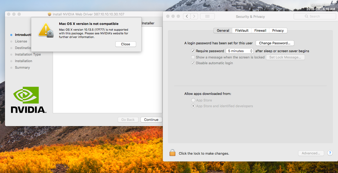

Ok so i Have the nvidia120 installed along with the 1070 ti aero in my mac pro flashed to 5,1 But running High Sierra 10.13.5! i notice that you guys were running 10.13.4 did i mess up my chances by installing upgraded high sierra 10.13.5? all commands listed above are enabled in terminal as well. do i have the right OS and if i do what should i do about this error message?

I installed my 1070 a few days before 10.13.5 dropped but I upgraded without any issues.
Looks like you ar trying to install the old driver for 10.13.4. Try this one

i just did this as soon as u posted this thankyou for reply again bro. especially this late. but im going to restart since it gave me prompt to do so and see what happens

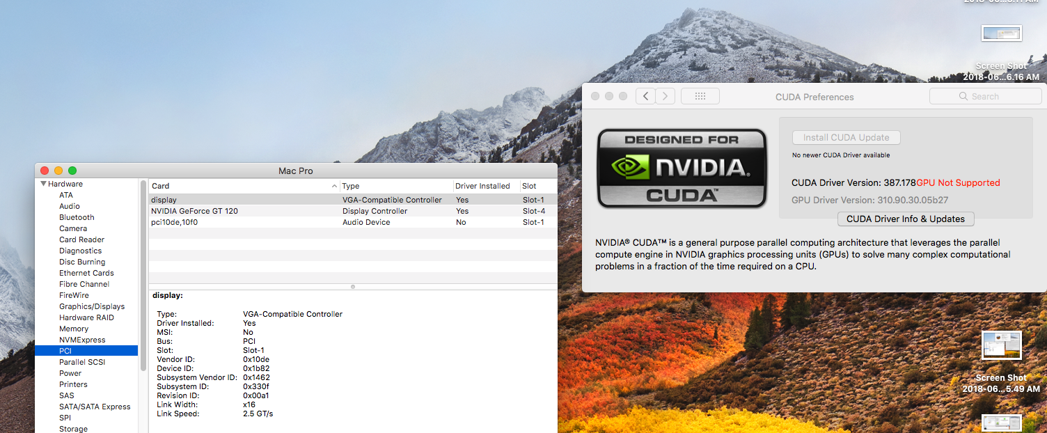

This is wat i got after reboot
