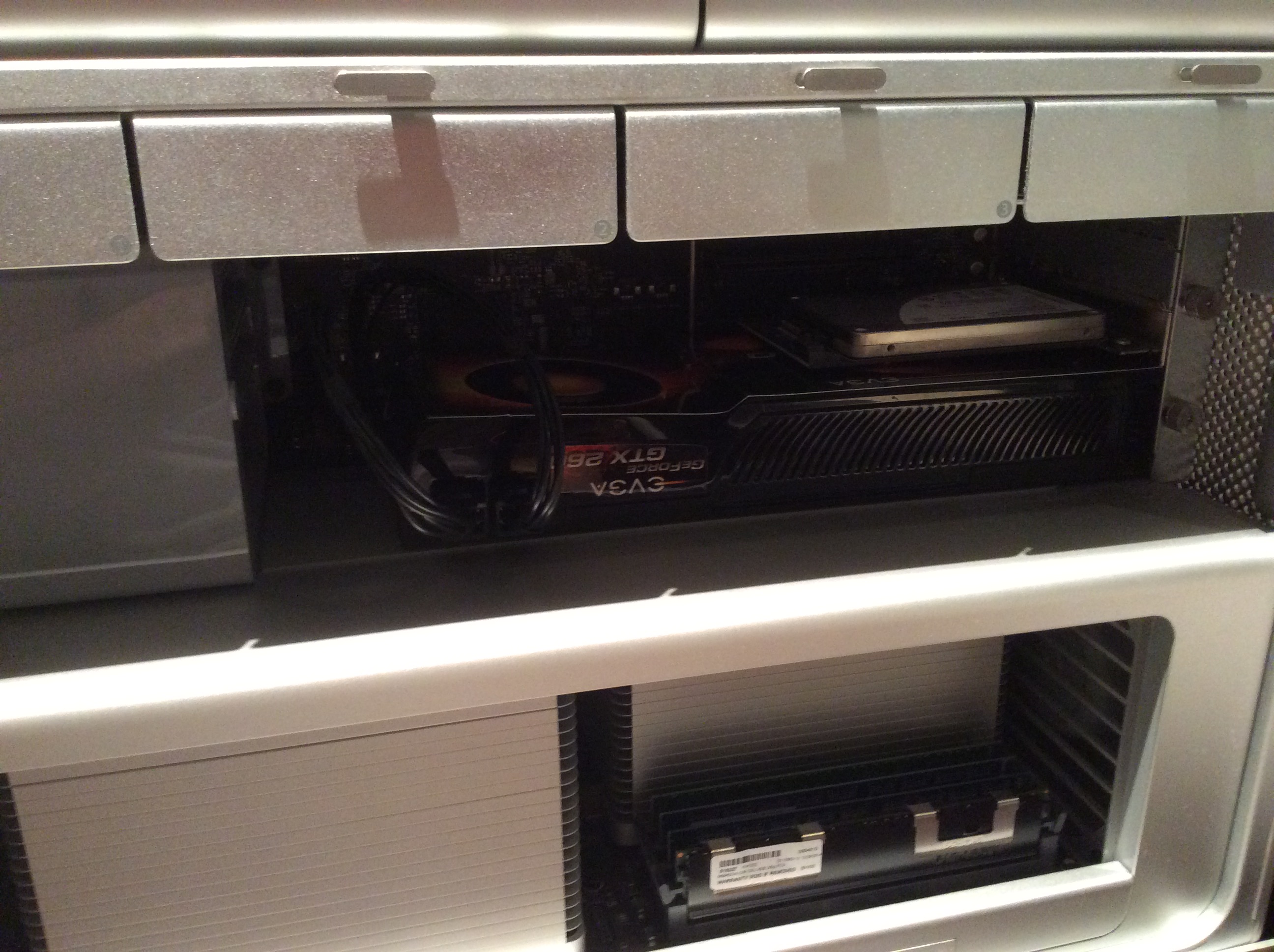

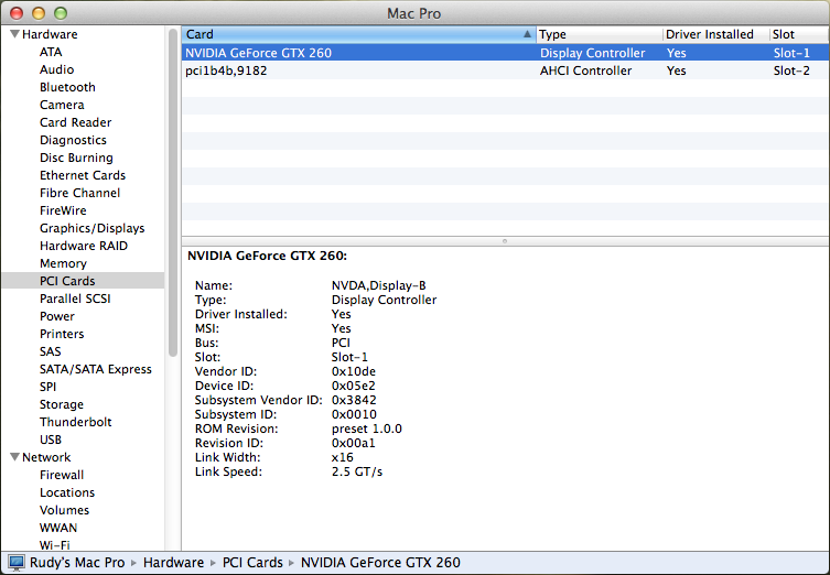

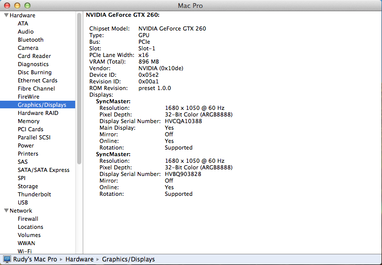

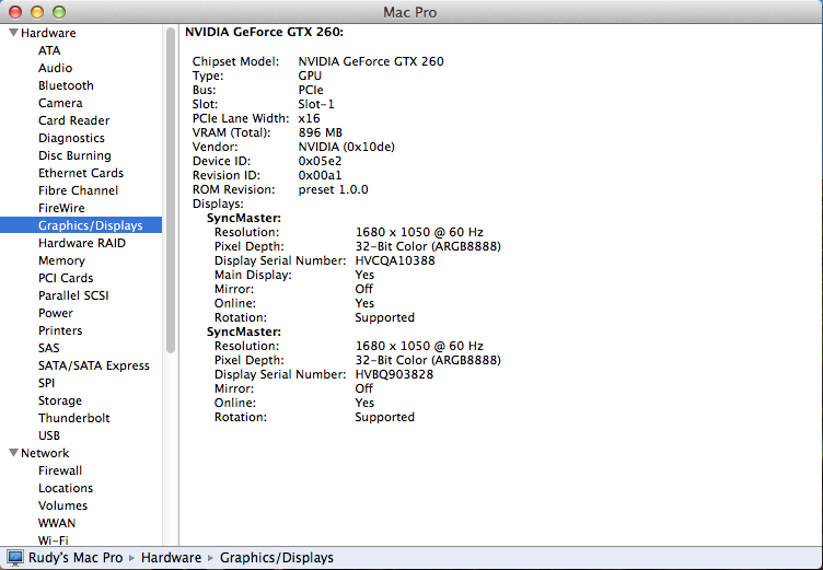

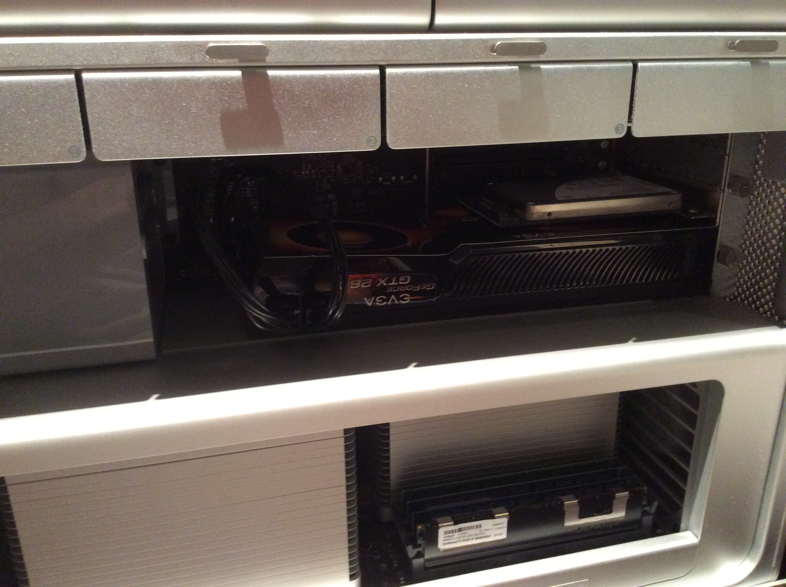

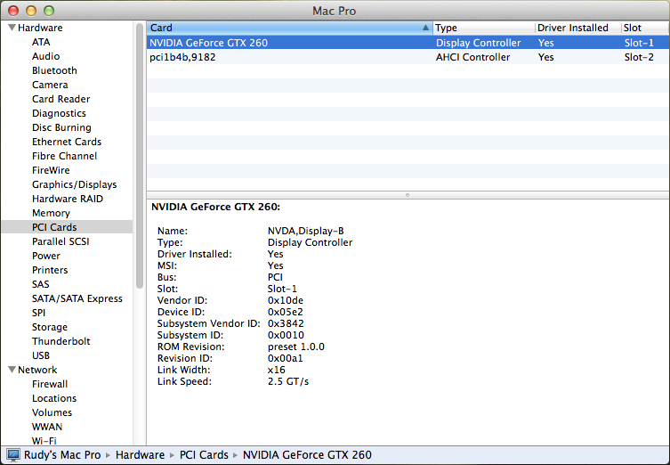

For those interested, I installed my 260 Superclocked in my 4.1 Mac Pro. No-boot screen obviously. But it is recognized right away as you can see below. Don't think I need the nvidia drivers (unless I should?).
Not sure what all the info means in system report. If anyone knows, I'd love to understand these.
Will run try to run some benchmarks.
