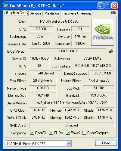

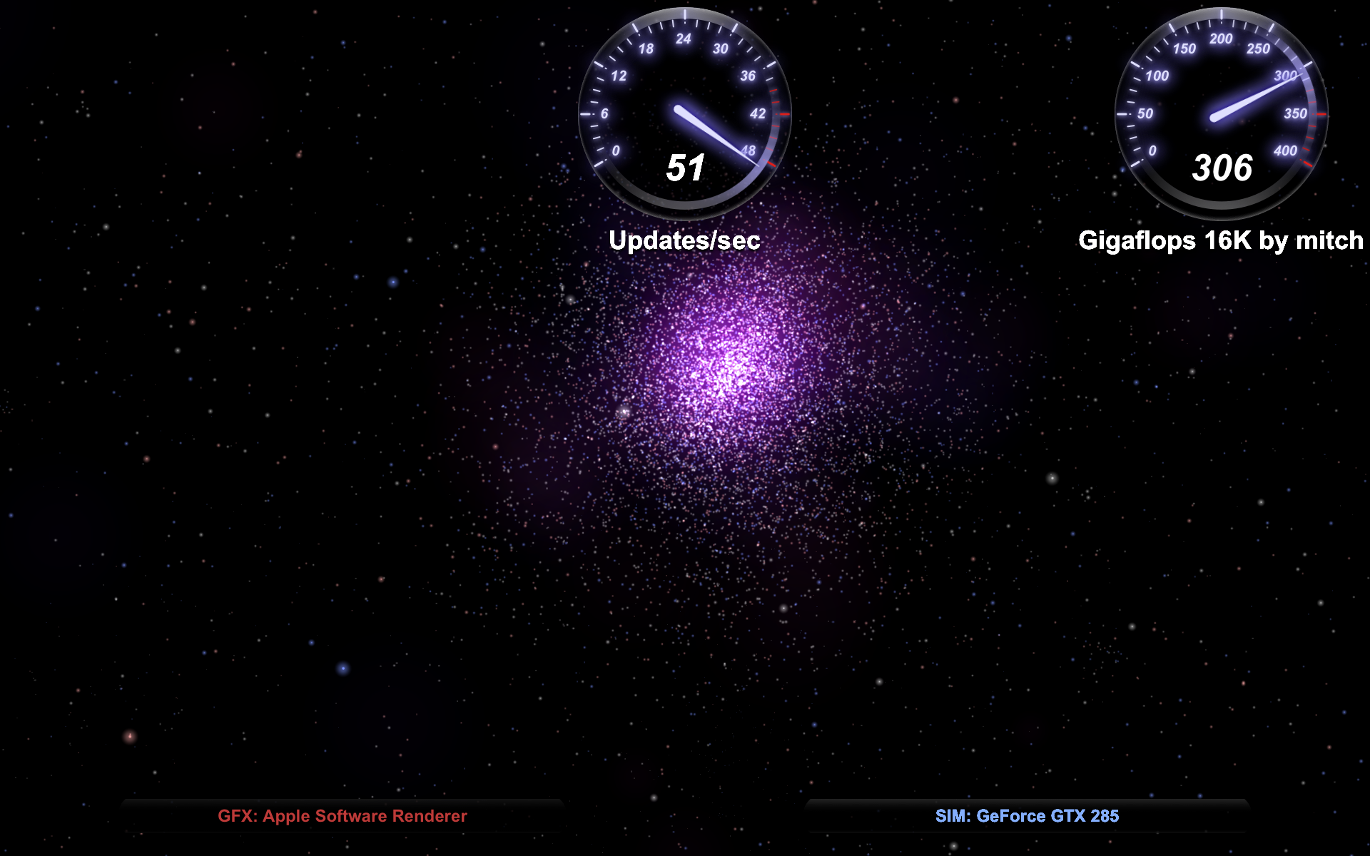

test result : Working Success!
I have tested the flashed GTX285. Not test the 2nd port because it is HDMI.
But the DVI works OK. Here is the details:
MAC PRO : 2008 Quad-Cord XEON 8GB ram
DISPLAY: PHLIPS 1920 1200
DISPLAY CARD: NV GTX 285 flashed
