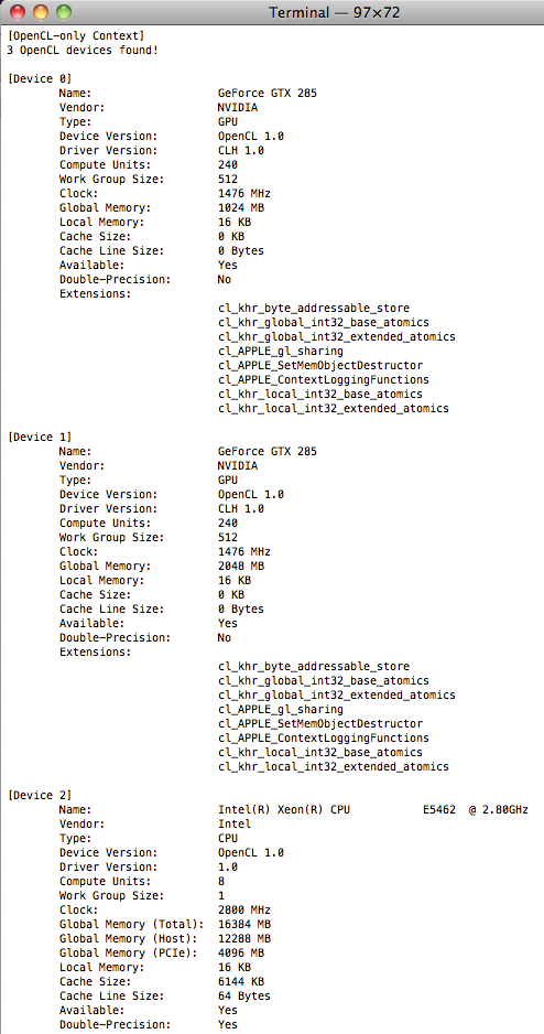

Another thing about 285s: OpenCL
This is a slight distraction from the OP, but as this thread might attract 285 owners I will put it here. So I have got Snow Leopard up with a Mac 285 and an injected PC 285 with 2G RAM (the Palit card). I am using CoreVidia 1.1 to do the Snow Leopard injection, though I am sure netkas' tool is fine too.
1. OpenCL recognizes both cards fine
2. The 2G of RAM on the Palit card is found (my injector is set to 1.5G, but that is probably cosmetic) and reported OK.
3. oclinfo reports 3 devices under the OpenCL context, but not the PC card under the combined OpenCL+OpenGL context [?, why, consequences ?]
4. More worrying is the double precision "yes" only appearing against my Intel CPU and NEITHER Mac nor PC 285.
Does anyone know about double precision under OpenCL on GPUs - this is bugging me as these cards are CUDA compute level 1.3 cards with dp support. Screen shot attached FYI. (OpenGL issue not shown)
This might be nit-picking - the idea of writing some code now to run on either the CPU or GPU is actually exciting, but I am still a bit stuck for good examples to steal ideas from!
