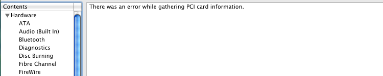

Not exactly - what I said was "The GTX is a little louder than the 8800GT". It's quieter than I expected for such a huge beast, and not running very hot at all. It isn't any louder in OSX than it is in Windows. It definitely doesn't have the annoying airplane engine whine of the 8800GT which gets really loud as you crank up the speed. I was using rivatuner to adjust the fan speed on the 8800 but I stopped because I was getting some weird results.
Edit: No, I haven't modified any drivers.

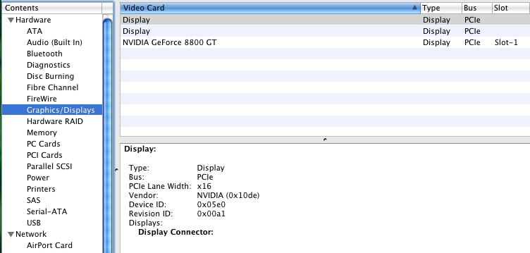

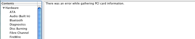

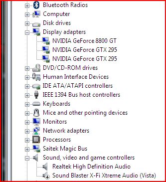

Here are some screenshots. As you can see, Windows has no problem recognizing both cards. OSX has no idea what to make of the gtx 295. I'm hoping this might change with 10.6.

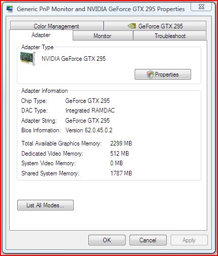

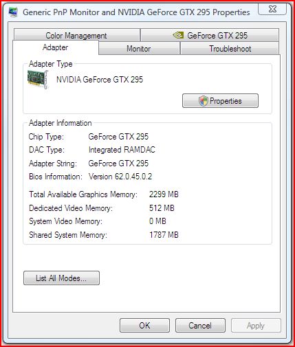

... I thought it was interesting that the gtx shows up twice in the device manager. Here's another screenshot showing the gtx 295 specs in the appearance control panel.

Thanks for the screenshots,
I see that u have mounted the 8800gt in Slot 1, and the 295gtx above.
I think only slot 1 is a the pci-e 16x slot, above there are three slots with 4x and 8x.
Wouldn't it be better to mount the 295gtx in slot 1 to get the full power of the beast, an mount the 8800 in a 4x or 8x slot??
