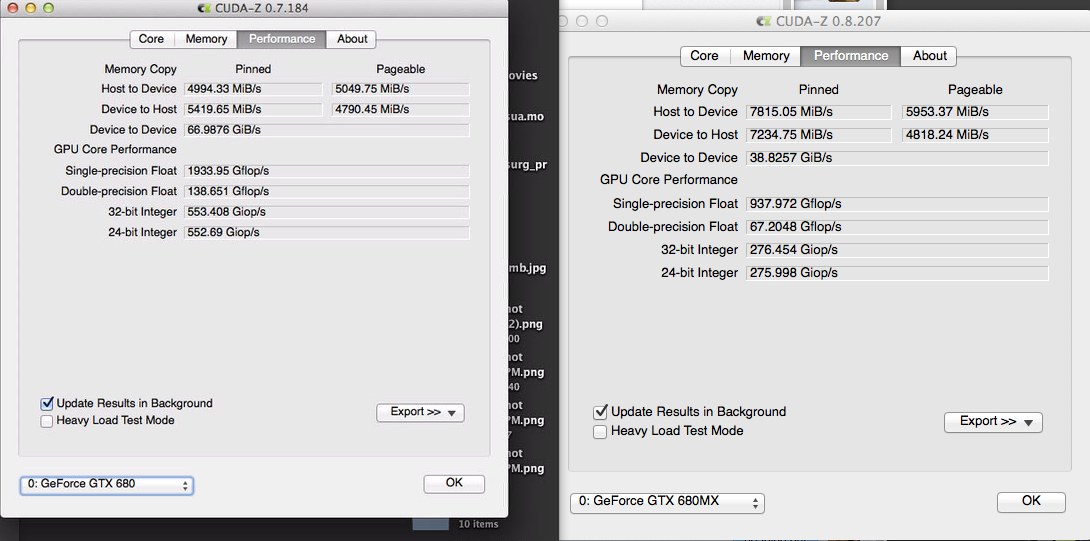

Heres a little difference that i found so far...

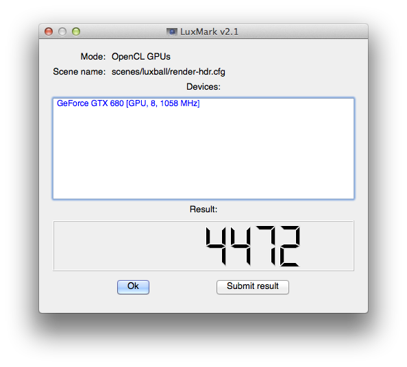

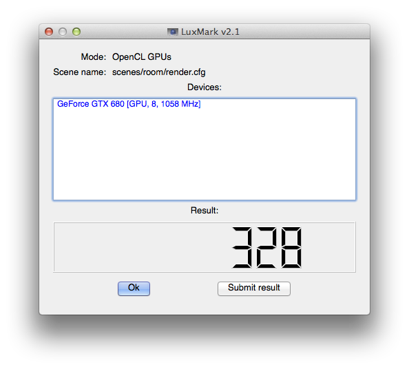

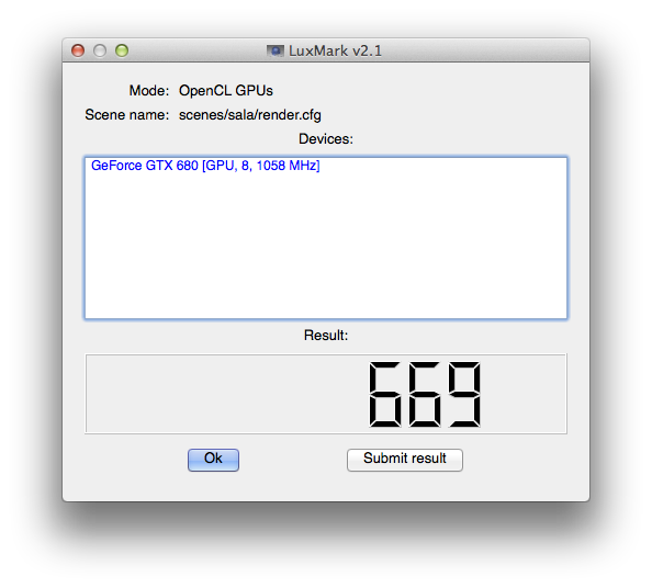

Heres luxmark and heaven,

OK, thanks, my scores on Luxmark are little lower, but pretty close to yours. Meaning your card is not throttling under load and is working fine.
