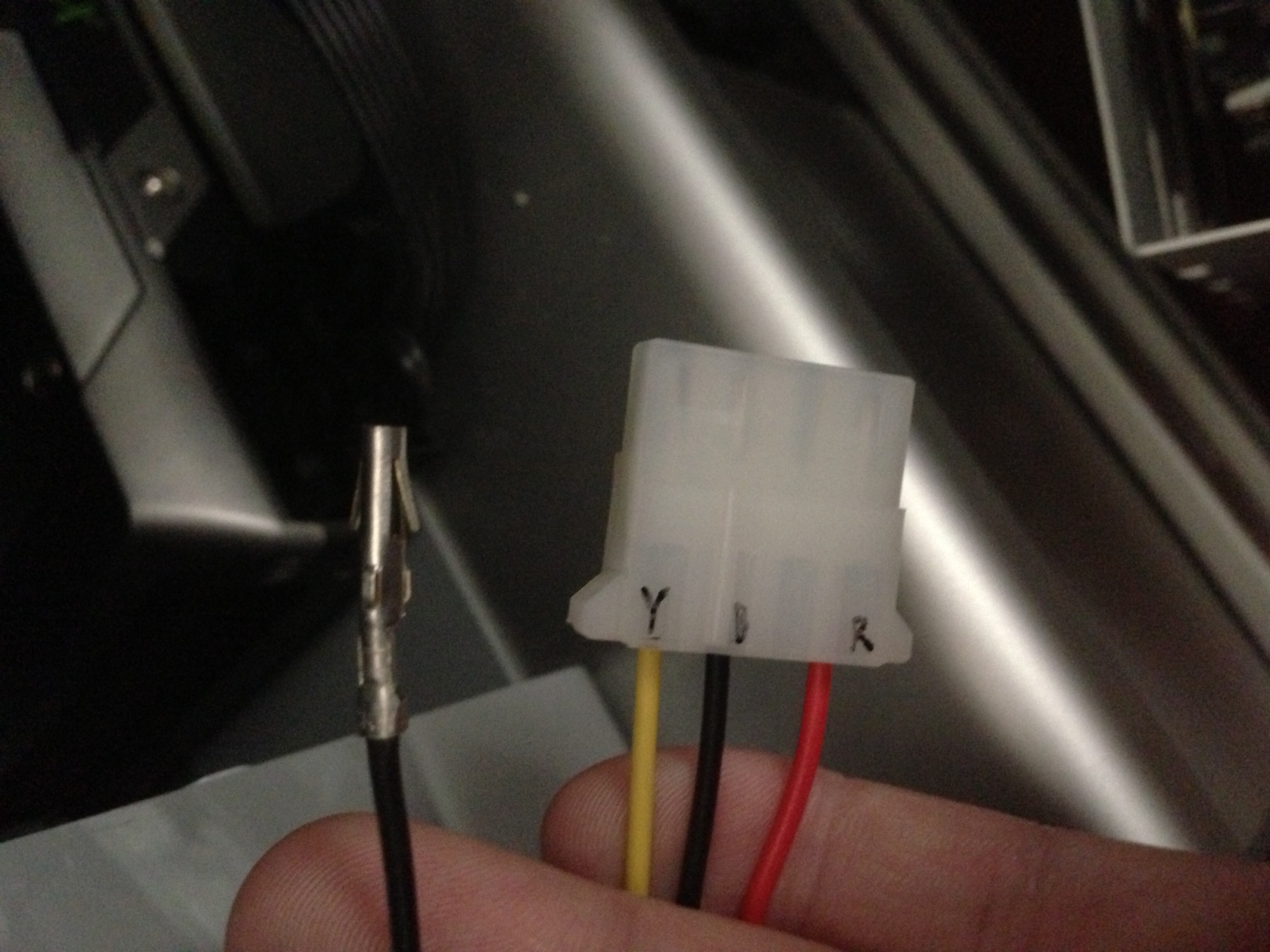

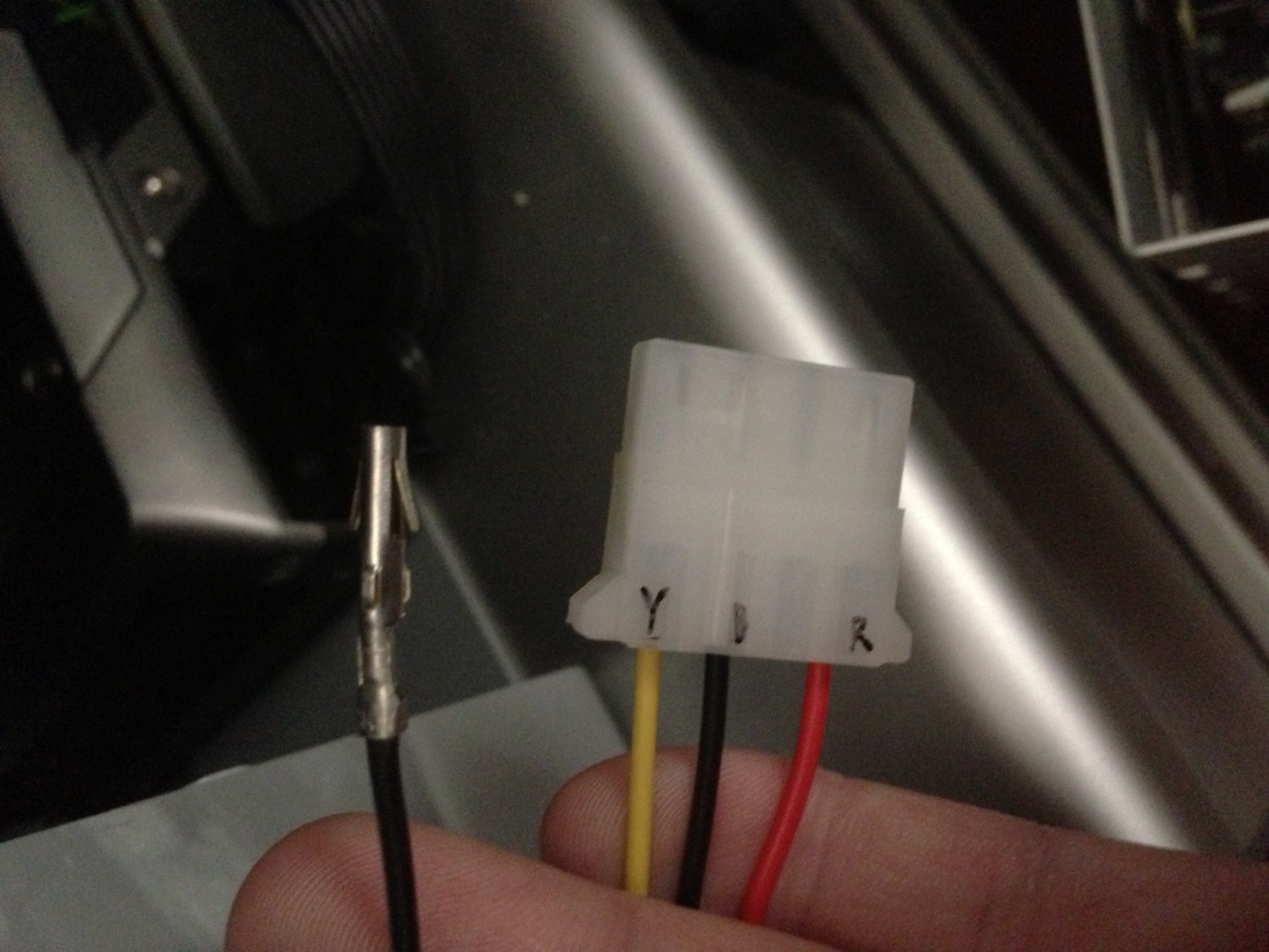

Actually, I ended up going through with my original plan to draw power from the spare SATA 15-pin connector in the 2nd optical bay. The challenge was figuring out how to pass the Molex extension cable from the optical bay into the backplane board (PCIe slots). Eventually I figured out that by removing the nylon housing, I was able to expose the individual 4 pins and thread them easily into the blackplane board. Once that was done, I simply reattached the nylon housing and was good to go. All the other connections fell into place easily.
Here's the final order:
1) Connect SATA 15-pin connection (from 2nd optical drive bay) to SATA 15-pin to Molex 4-pin adapter
2) Connect SATA 15-pin to Molex 4-pin adapter to Molex extension cable (mine was 17" in length)
3) Remove nylon housing from open end of the Molex extension cable to expose the 4 pins (yellow = +12V, black = ground, black = ground, red = +5V). Take careful note of the ORDER of the pins (see attached image, I wrote on the nylon housing to indicate where to reconnect the pins).
4) Pass Molex extension cable from optical bay to backplane board (PCIe slots)
5) Reassemble Molex extension cable nylon housing.
6) Run Molex extension cable out an open PCIe slot (i.e. exiting the workstation)
6) Connect Molex extension cable to Add2PSU.
7) Connect Add2PSU to 24-pin power supply cable.
8) Connect 24-pin power supply cable to external PSU.
9) Run power supply cable connected to GPU out of same open PCIe slot and connect to PSU.
Done! Your Mac Pro and GPU should now work in sync, thanks to the Add2PSU. Sleeps, shuts down, starts up as if running off the Mac Pro's internal PSU. Best part is, depending on your PSU, you might have more power to spare for another GPU!
