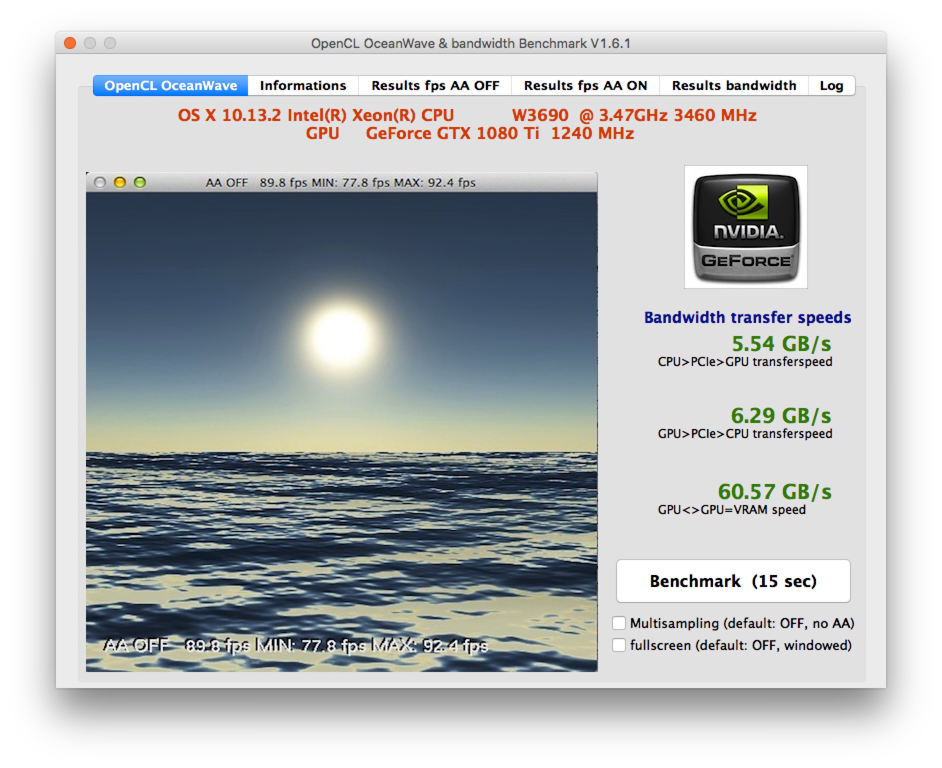

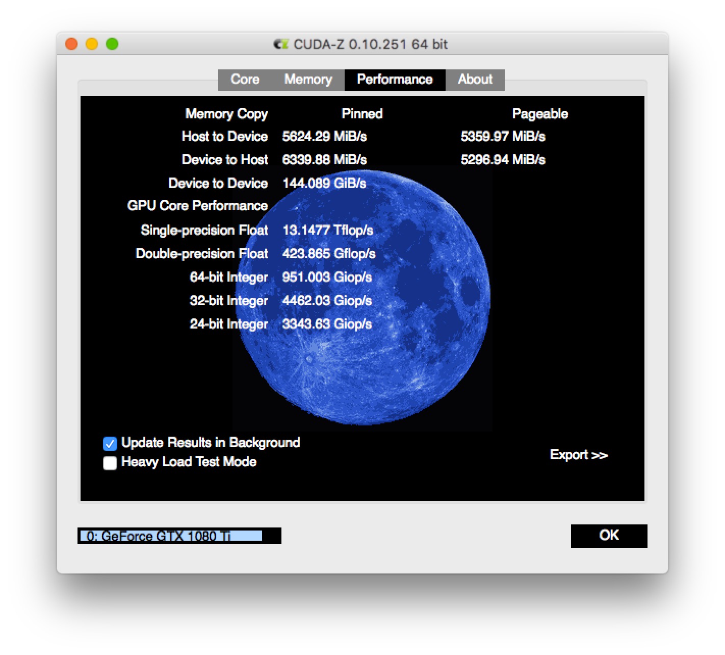

From the screen capture, it looks like your card is working now (both MSI and the ROM revision is back to normal). Or still only black screen?
That 2.5GT/s is cosmetic. If you want to know the real link speed, you can use CUDA-Z or openCL OceanWave. Both software can show you the benchmarked link speed, which should be around 5GT/s. (CUDA-Z is better for this purpose, OceanWave may occasionally shows 2.5GT/s because the link speed is actually dynamically adjusted. CUDA-Z can keep updating the result to avoid "taking data at the wrong time")

Hey thanks for the suggestion of using CUDA-z. i tried the waves one however just got a beachball. here is a picture of my current card im not sure what i am looking for but the device to device speed seems to be half of yours.
Its strange because my numbers in openCL ocean waves are quite a bit lower than yours also
That's why I recommend CUDA-Z. You may try OceanWave a few times, it may shows different result. My above OceanWave samples are all from the same Mac, same hardware, and just keep re-open OceanWave, then I can capture both 5GT/s and 2.5GT/s screen capture (CUDA-Z always report the correct number, so that I can't capture the 2.5GT/s screenshot)
