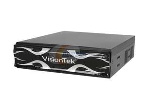

If I were to get an additional power supply for the card does anyone have any recommendations?
This one has been mentioned by some forum members. I do not have any personal experience with it.
In regards to Macvideocards' claims that his modified GTX 770 and GTX 780s not needing additional power supplies, it has been shown that even if under clocked to where these cards have a TDP of 225W or less, there's no definitive way to tell how much and were they will pull those 225W from. Since 8-pin connectors are specced to provide up to 150W, it's conceivable that these cards can try to pull 150W from that 8-pin connector and the remaining 75W from the PCI-e slot and the 6-pin connector.
At this point, I don't think anyone can prove that it won't cause long term damage. It's entirely possible that problems won't manifest immediately. If/when that happens, who will you blame? Who will you turn to? Will Macvideocards still be around? Will he be responsible for blown logic boards?
