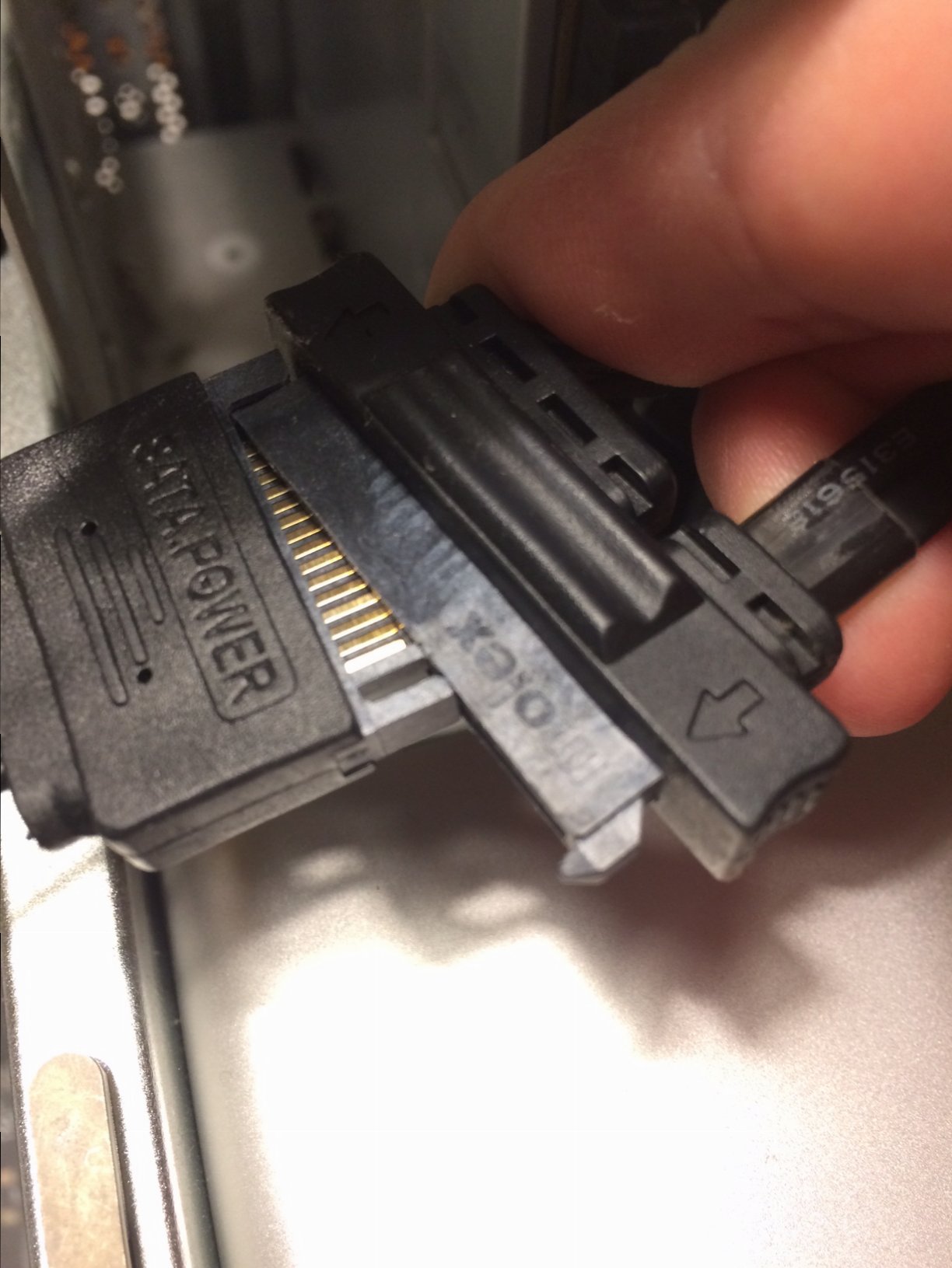

Did that Sata to 6 pin adapter just plug and play for you or did you have to modify it to plug into the optical bay connectors? I have one that's similar if not the same, but the "tooth" on one side prevents it from plugging in fully to the optical bay cable or any of the hard drive ports since it's designed for a different type of SATA plug. Pic attached.
This is the one I got and it's not working. I could modify it (don't have a dremel, but I'll find something), but if there's something that'll plug and play I'd rather do that.
http://www.amazon.com/gp/product/B00DP98P0A?psc=1&redirect=true&ref_=oh_aui_detailpage_o00_s00
Don't need a Drexel, use your thumb and snap it off

Thanks MacVidCards, it totally worked. I've actually met you before IRL, I brought you a card to be flashed for a production company I worked for, and I think it's great what you do. I'm making a YouTube video about this install, I'll give you a hat tip on the Sata tweak.

glad it worked, just have to snap off one side, Apple made the the SATA plugs into one, but PC parts don't come that way
