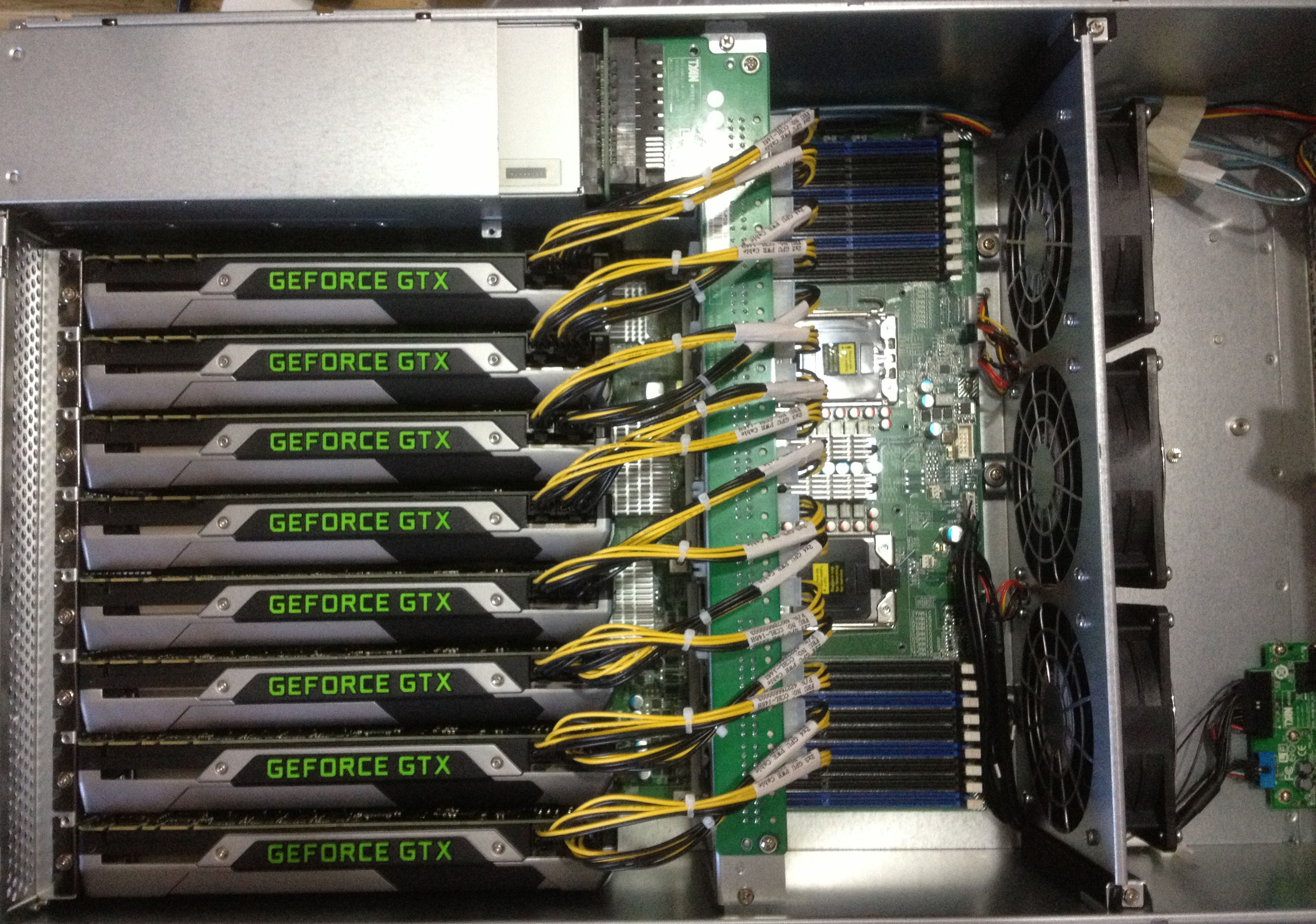

To get the full power of CUDA in a Titan, you'll have to run it in Windows to activate all of the double precision floating point peak performance power for Octane render [see, e.g., post #564 here: https://forums.macrumors.com/threads/1333421/ ]. Double precision peak floating point performance is capable of being increased by over 600% and single precision peak floating point performance is capable of being increased by over 40% with Nvidia Control Panel and Precision X in Windows. There is no software utility to do so in OSX, even ignoring the other issues.
Make sure that the Cubix has adequate power for the number of Titans (and other cards) that you intend to install - each Titan card needs at least 250 watts and at least 325 watts when fully unleashed. My Tyan server (AlphaCanisLupus0) has 8 Titans for Octane render, utilizing three 1000 watt power supplies. AlphaCanisLupus0 has over 16 TFLOPS of double precision peak floating point performance and 50.1 TFLOPS of single precision peak floating point performance (vs. the next top of the line Mac Pro, which is advertised to have about 7 TFLOPS of single precision peak floating point performance).
BTW: I got my barebones Tyan server for about $3600 from here: http://www.superbiiz.com/detail.php?name=TS-B715V2R . N.B. - 2400W [(2+1) 2400W @200-240V], Max. 12Vdc@ 199.6A / 3000W [3 x1000W @100-127V], Max. 12Vdc@ 249.6A; Note: Only one AC inlet allowed per circuit breaker per http://www.tyan.com/Barebones_FT72B7015_B7015F72V2R .
