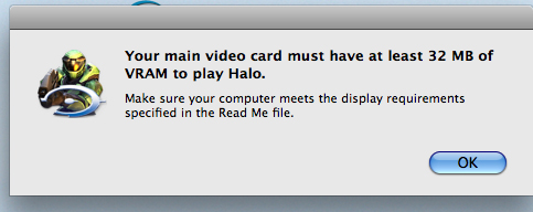

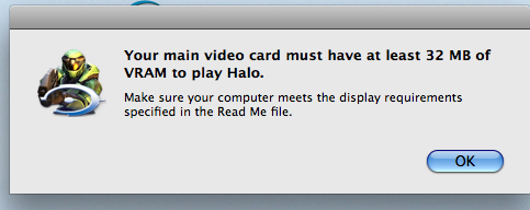

Halo come up with a warning that it needs at least 32Meg of VRAM to run.

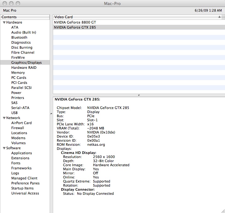

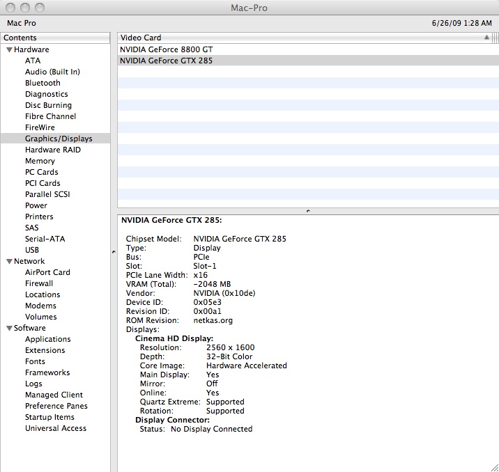

Part of using the injector has been that the reported VRAM was incorrect. Using a tip rom Netkas I was able to mod a line in it to get the 2048 to show up.

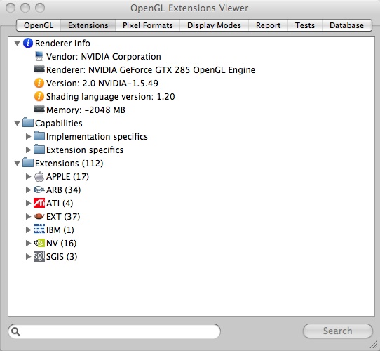

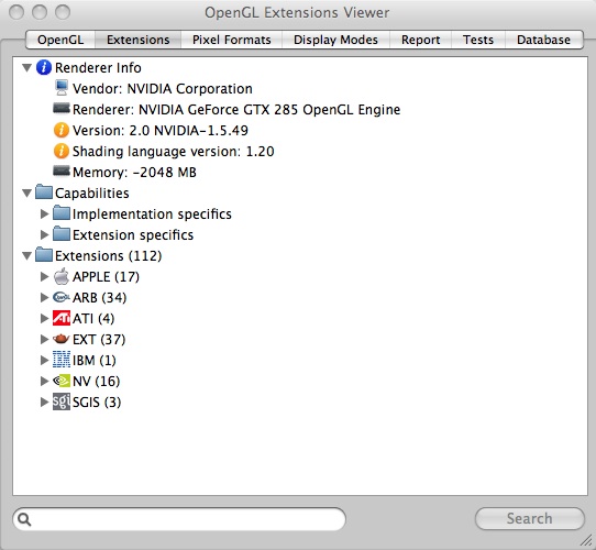

OpenGl View always gets this number right without promtping. But in both OpenGl View and System Profiler, the number shows up as a negative number. Which is especially odd, as the numbers are coming from different places.
Which means that somehow the OS is reporting "2048" as a negative number, no matter where it comes from, when used in the field related to VRAM.
So while I can bench the card in OpenGl View, I can't in other 3D apps as they sem to believe that there is NO VRAM.
I am certain that this is merely some bug related to the fact that up until now there haven't been cards with 2 Gigs of RAM. The most "officially supported" RAM on a card so far is the QUadro with 1.5 Gigs.
To be clear...the System Profiler shows it's value because of a Hex value for "2048" has been entered. The Opengl View vale of "-2048" is a number it got from the card/OS.

sys profiler value is cosmetic and can be fixed by setting for example 1.9GB
but open gl value cant be fixed that easy, ogl application gets vram size from ogl library, then ogl application think its signed 32-bit integer and here problems come. ( http://en.wikipedia.org/wiki/Integer_(computer_science) )

Oddly, in 421a it reads in Sys Prof as having
"VRAM (Total): 4294965248 MB"

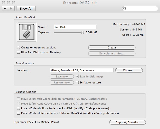

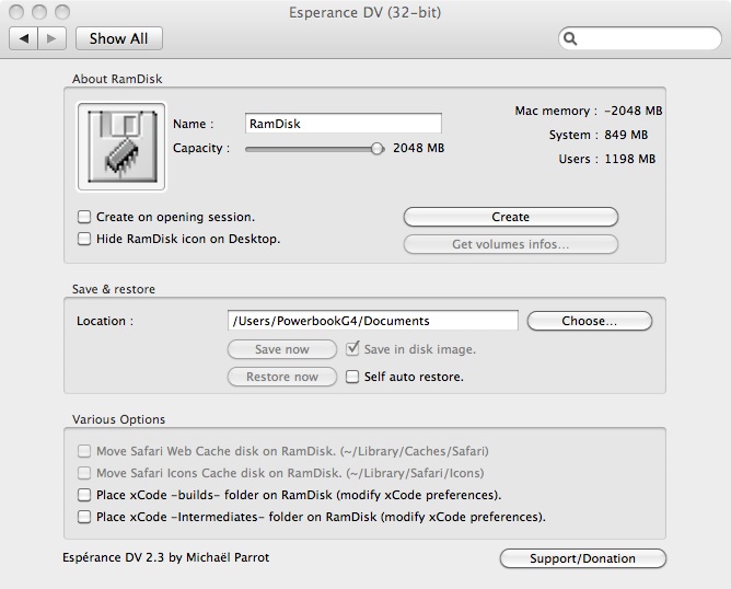

Was playing with an old RAM disk program and noticed the same issue. Despite the 17Gigs in my system, it sees but 2, and those are of negative variety. (421a) (only seeing 2 is likely due to age of this program...)
What is best way to bring to attention of the Apple OS writing crowd?

I just reran some stuff on both my 1G Mac 285 and injected PC 285. OpenGL Extensions viewer indeed reports -2048M under 10.6.2 for the 2G card, but both CUDA and OpenCL are still recognizing the memory properly, so this problem is a function of how the card is queried. Maybe CUDA/OCL bypass the problematic software?

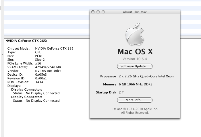

Unfortunately, my EVGA GTX 285 2GB still shows incorrect VRAM in System Profiler (mine shows 4294965248 MB !) in 10.6.3 🙁
10.6.4 ----still here !!!!
Arrrrr !!!!!

Just tried another GTX285 2 Gig out via injector. Still shows whatever amount you want via ATY_Init in Sys Profiler, but to OpenGl Ext viewer, it has -2048.
So, several apps won't open. Bioshock refused but Steam / HL2 worked. Doom 3 crapped out, but Cinebench OpenGl test works fine.
The command line NvClock app seees the amount of RAM as 2048, so at some level it is correctly numbered. (unless this is parsed from BIOS instead of "read" from a register)

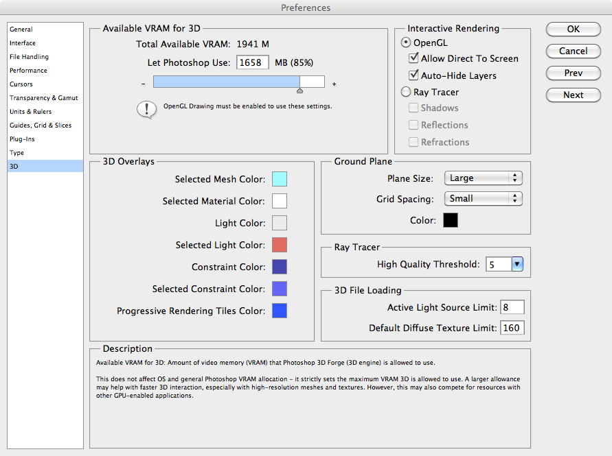

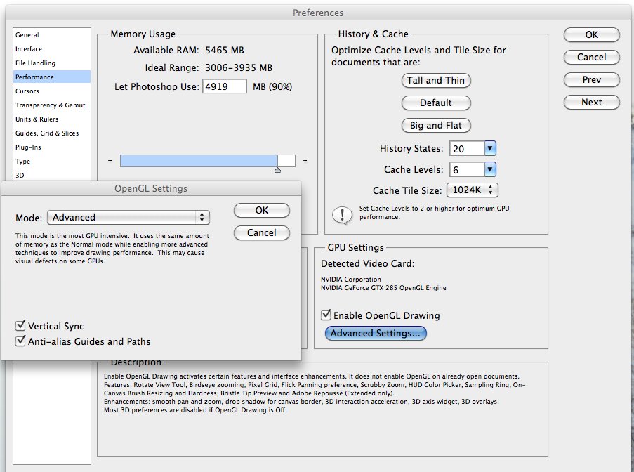

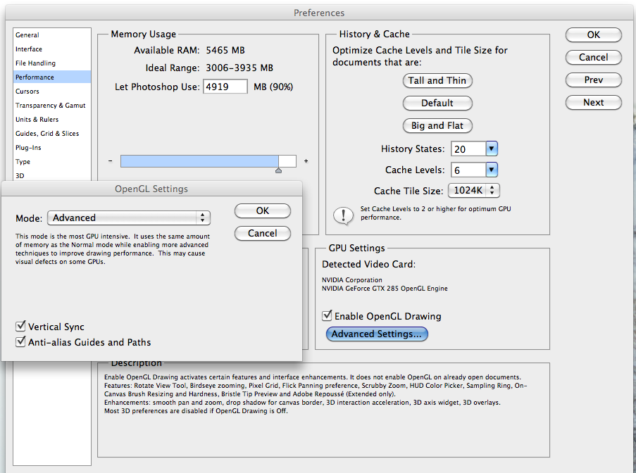

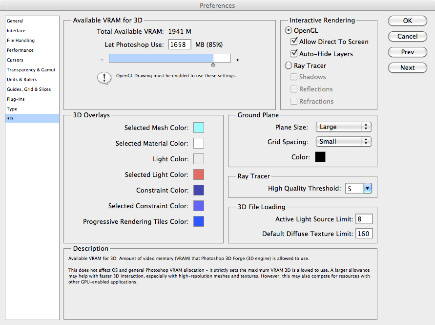

So while Apple's own Operating System is completely flummoxed by a GPU of 2 Gigabytes and then incapacitates numerous 3D apps as a result of it's inability to count past 1536, there is one App that knows exactly how much VRAM there is.
Apple 0
Adobe 1
Can you say "Embarassing" !!! ???
